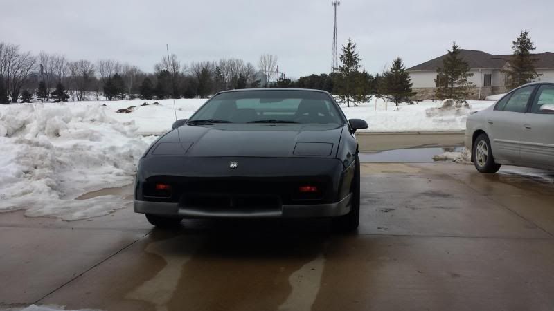

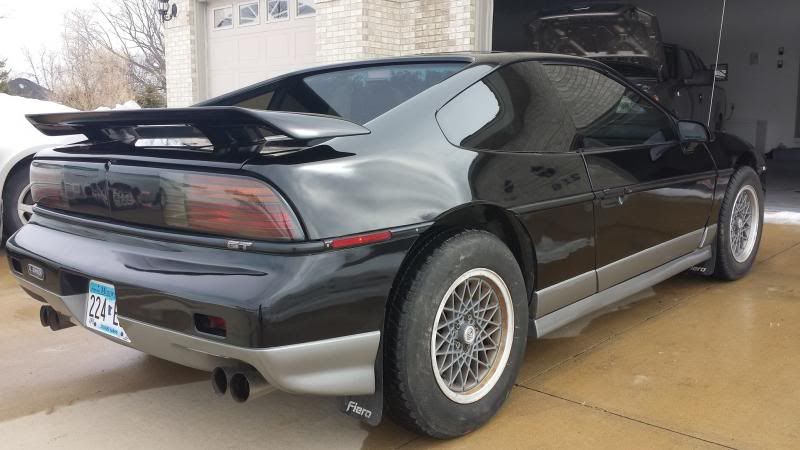

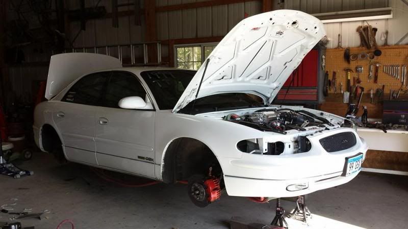

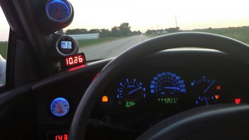

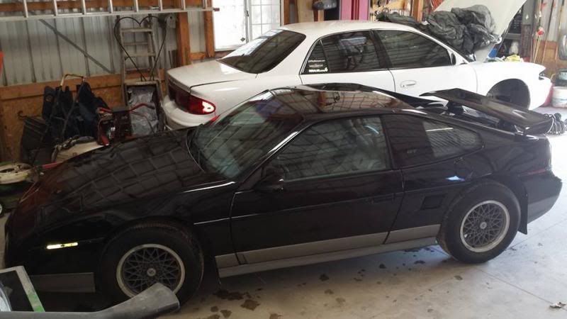

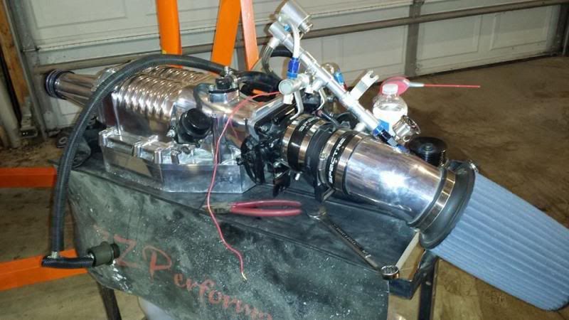

Hey guys. I recently picked up a 87 GT and am planning to swap my 11.8 second @115 1/4 mile motor from my Regal into my fiero. I've been in the 3800 scene since late 07. I've done just about every mod that can be done to a 3800. It was always my goal to get into the 11's in my regal then swap the motor into a fiero so I can hit low 11's then 10's with No2. I'm going to need some help doing this swap, wiring guides, motor mounts, axles, headers, exhaust, clearance with the rear hood, ect. I'll use this thread as my build thread and add to it over the years. Here are a couple pictures of my regal in action and a few of the fiero. Thanks for reading!
Heres the Regal in her demod state and in its prime

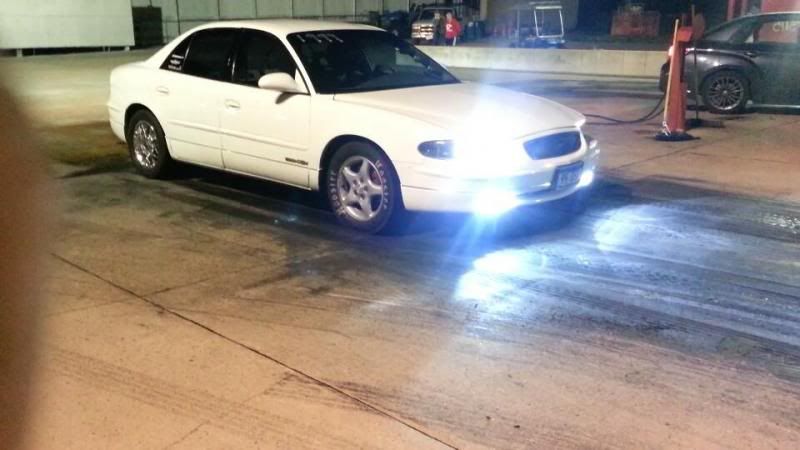

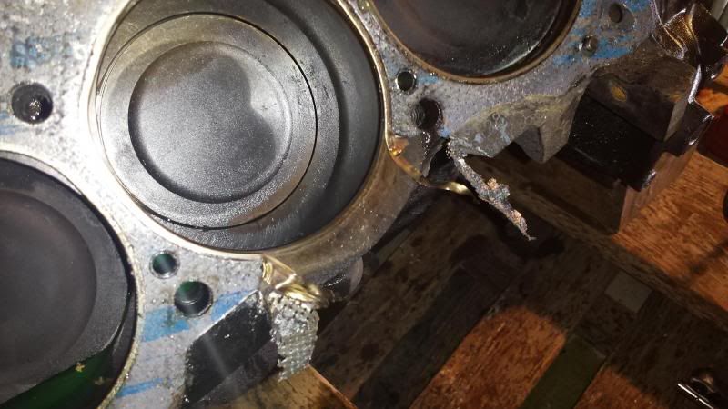

Head gasket pushed out at 90mph on my 11.8 pass
The 11 second 1/4 mile run
http://www.youtube.com/watch?v=SQT4X2eBlR8
Traction issues as usual with nearly 400whp in a FWD wbody on street tires.
http://www.youtube.com/watch?v=skw_GW_rxZg
11.8@115mph 1/4 mile 1999 Regal GSX being demodded for swap into a 86+ Fiero GT.

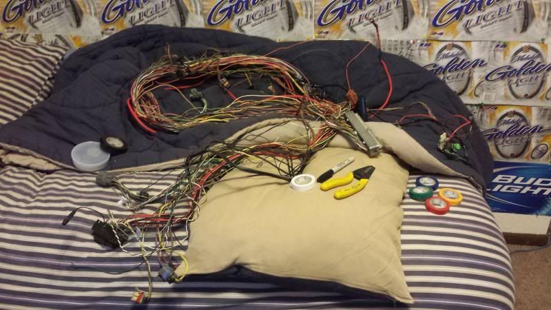

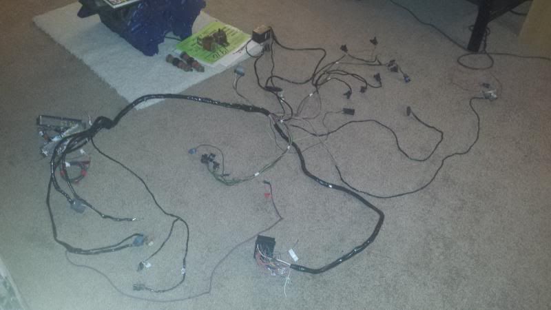

Ok maybe they can and they really are not that hard a job to do. If you need any wiring help I am always willing to answer questions but it is easier to just email me dansflyer@live.ca I would suggest wiring it all as a GTP instead of the regal and have the PCM programmed for the GTP with all the mods you have
DARN Cars now open with
Over 30 years wiring experience between cars and trade as an avionics technician in both Canadian Air Force and civilian aviation.
Over 25 years experience building and modifying cars.
Over 10 years of full Fiero engine swaps and harnesses building and still going.

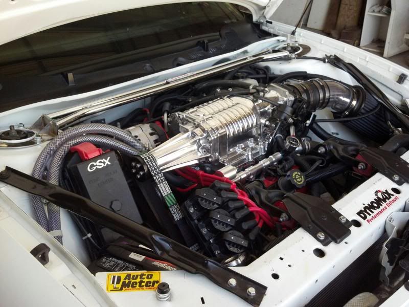

L36 block, milled L32 heads, 5 angle valve job, smoothing ports, ported LIM, ZZP Stage 2 IC, ported and polished GenV, 2.6 pulley (14psi-15psi) 77mm N* TB, LQ4 MAF, ZZP AFC tuned at 110% headroom, 4" intake, E85, 65lb injectors, ZZP 1st gen fuel rails, headers, 3" mandrel dual exhaust with 3" electric cutout, 23* of WOT timing. Built Tim King Race trans. 3.29's, blue pack clutches, ZZP 300m input, zzp pump shaft, zzp 2500 stall, TEP valve body, Tim's custom shift kit, Transgo kit, Modded diff (no not an Intense).
Regal also had full suspension. KYB AGX adjustables with vogtland springs, GMPP front/rear sway bars, GMPP trailing arms, front/rear STB's, poly mounts all around.
Regal was made into a GSX clone by me. Its a flagship car on regalgs.org and well known
I currently hold the #6 fastest regal record in the nation and #2 in MN. #1 if we dont count the other guy since he was turbo'ed and ran .1 seconds faster lol. All this is about wbody gen regals (97-04)
All my security is turned off in my PCM already. I own a tuner. I don't even need a key to start the buick anymore. But I choose to use one

Here is a little update to the Fiero, I have not really settled on a good name yet. For the collector plates I'm thinking whiney6 but that will suck when I go turbo with it later on. I know I'll have this car for a very long time so I'm sure I'll pour a **** ton of money into it. It's strictly track and a toy to go to shows in. Not many creature comforts. Goal is running 11 flat with the swap and high 10's with further mods. The car now has a rod knock (2.8motor) that I'm guessing came from pitching the car sideways around every corner. Why not I don't care about the power or drivetrain. Hope it can make it 5 miles back to my shed once its nice enough to come out from storage. I've got a 6 point roll cage going in it soon. Got to arrange a date to go pick that up. Also still dragging my feet on the motor mounts/axles. I've got the engine harness done except for mating to the c500 and other parts of the fiero. Mounted the driver side race seat. Suede Corbeau FX1-Pro. Its a epic seat with the 5 point harness I will have no issues during tech. I did a couple things for looks on the fiero. I converted all but the PON TIAC text to LED's. Not a cheap thing to do plug and play but it looks pretty sweet in action.
I'm kind of a picture whore and if your like a lot of people they would rather look at pictures than read. So here is a few.
Current state more or less 20% tint tinted 1/4 windows
Back when I was pulling all the goodies out of it before I sold it.
Headgasket from the 11 second pass

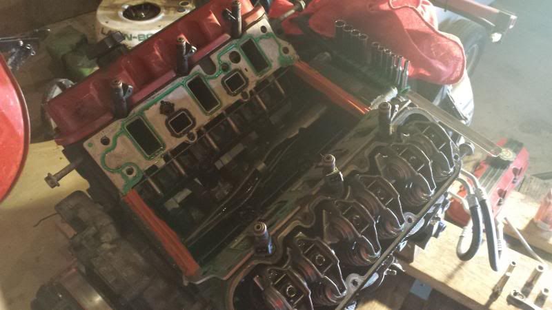

ARP headstuds and Victor Rienz headgaskets
Going to carbon fiber hydro dip my filled valve covers
LED swap
Engine harness project.
Found a home for a couple of my gauges. Gonna mount more to the right side of the cluster. Directly to the right of the trunk latch button
S3 Aluminum oil pan, Getting powercoated black or something different like light blue. I need some character for it. 3core raditator for the swap in the background. My motor table seems to always be a shelf for car parts.

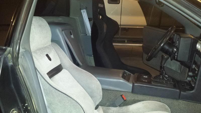

Seat mounted temporaily on stock brackets for now. I will purchase two from the fiero store. This shows about how much room I'll have with the 6 point cage. With my helmet on I have very little wiggle room. Hope those aftermarket seat brackets are low
Had the vents powerdercoated black. Once I tear apart the fiero I'll be powdercoating lots of things.
Little pile of junk ready to go on the motor
Little project I'm working on. Farm truck and azn gave me the idea.
Now we just gotta make it look like this again but in a fiero!
11.8@115mph 1/4 mile 1999 Regal GSX being demodded for swap into a 87 Fiero GT.
11 sec pass>>http://www.youtube.com/watch?v=SQT4X2eBlR8
[This message has been edited by djlamp14 (edited 02-24-2014).]

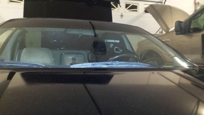

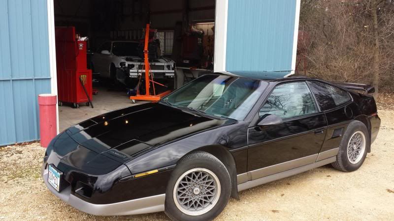

Took it out for a drive yesterday and today. That 2.8 starts knockin after about 3k rpms. As long as you stay under that it seems to run just fine. A few more weeks with temps over 30 degrees, all the snow should be gone and I can start ripping this car apart.
Got lots of parts on order and a list to order yet, that is ever growing. I missed always needing more parts. The buick already had everything I wanted for it.
I snapped a few pictures since it looked fairly clean. It needs a buff badly. In the last picture you can see just how much taller the Corbeau seat is than stock. With the cage this car is going to be a pain in the ass to get in and out of. I may look into getting a quick disconnect steering wheel for more room getting in and out if I can find something tasteful.
