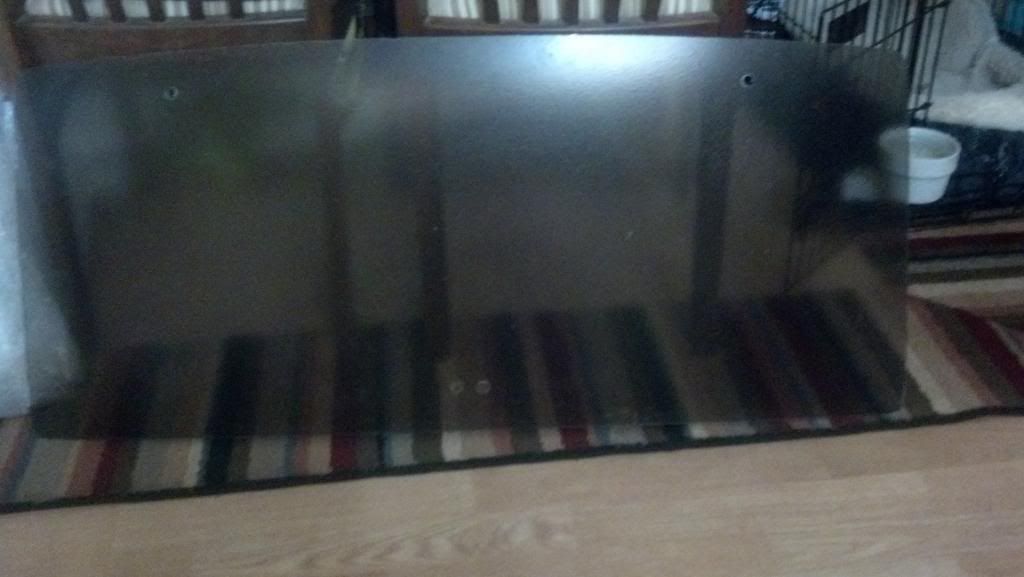

Ok, it's been awhile since I last reported on this, but I did get my sunroof, and now it's time to see how it performs against the OEM glass one. Some of you may remember my last thread I had in the Mall on the subject here: https://www.fiero.nl/forum/Forum4/HTML/066582.html

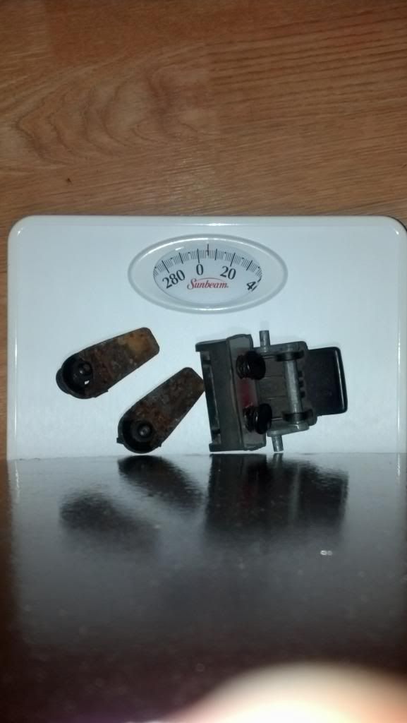

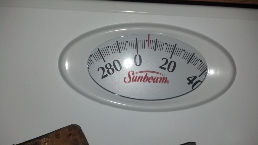

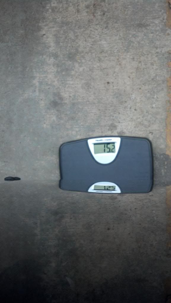

First off, I should note that there are a few things I have to do to make this a completely fair comparison. My old sunroof weatherstripping is shot so I will be replacing that soon. I also need to finish a 3.4L swap so I won't be able to do a road test right away. That said here's what I do have. Proglass did a really good job with the forming, and the contours were matched perfectly with the glass roof. As mentioned in the other thread, Lexan is flexible so it will be interesting to see if it maintains a weather tight seal with road vibration and chassis flex. It also might droop slightly when in the up position. Now onto the weight aspect. I tried to be as accurate as possible by weighing both sunroofs a minimum of 5 times each, but I was using bathroom scales instead of more precise industrial or commercial scales and I weighed the roofs on the edge so I had to use light finger pressure to keep them stable so I could weigh and still be able to read the scales. Because of that, results may differ slightly if anyone else tries this with more suitable equipment. I also used two different scales as the Lexan roof would not register the digital scale so I hope to re-weigh the glass roof on the mechanical scale to remove the variable of error that comes with using two completely different instruments. Ok, now the results. According to my measurements the glass roof weighs ~ 15.2 lbs (four times it registered that with the fifth showing 15.4 lbs). The Lexan roof weighed in at just 5.25 lbs with a +/- .25 lb margin of error. That's 10 lbs difference!! It might not sound like much, but if I were building an autocross car, I would want to squeeze as much weight out as I could to be the lightest Fiero on the track. It adds up especially if you replace all the other glass with Lexan. Anyway, here are the photos from my experiment:

I remember your thread on this. My only concern was not the drooping when open but when you latch the sunroof, will there be too much tension from the handle pulling down on the sunroof that the sunroof could be pulled concave or buckle right at the handle?

Sorry about the orientation on some of the pics. Apparently, photobucket didn't save my editing. Anyway, for my next post I hope to post acurrate measurements about the thickness of the roofs since the old thread had showed some concern that the thickness between the Lexan roof and the glass roof would not be the same.
^ That is something that I will be looking for during my experiments. I remember early Shelby Mustangs had a similar problem with their fiberglass hoods. Because Shelby did not change the tension on the hood springs to account for the lighter load, they would warp, but it would take a few years to do so. If the roof does warp from the handle pulling down on it, then I could find another way to keep it latched or ditch the project and save myself and possibly someone else the trouble. Either way, I'd still say it was worth the money to experiment.

Just a note... You can weigh the glass sunroof on the digital scale, then add the lexan one. Then just subtract the weight of the glass one to get the lexan weight. This way you are using the same scale, so no variances. Also the digital will probably be more accurate than the analog one.

The plexiglass likely isnt as rigid as the glass one. Ill expect the sides to bow up slighly when latched so the sides will leak and have wind noise. Airflow may also help pull the sides up. I know my racecar (thunderbird) with lexan windshield would pop up and out (not pushed in like you would think). Thats why we had metal clips bolted thru it to the body. Pretty sure there is also a vacuum over the roof close down too. Maybe your wont.
