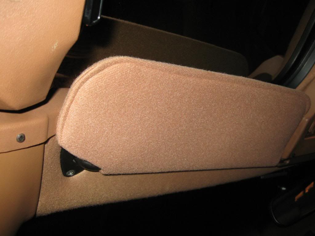

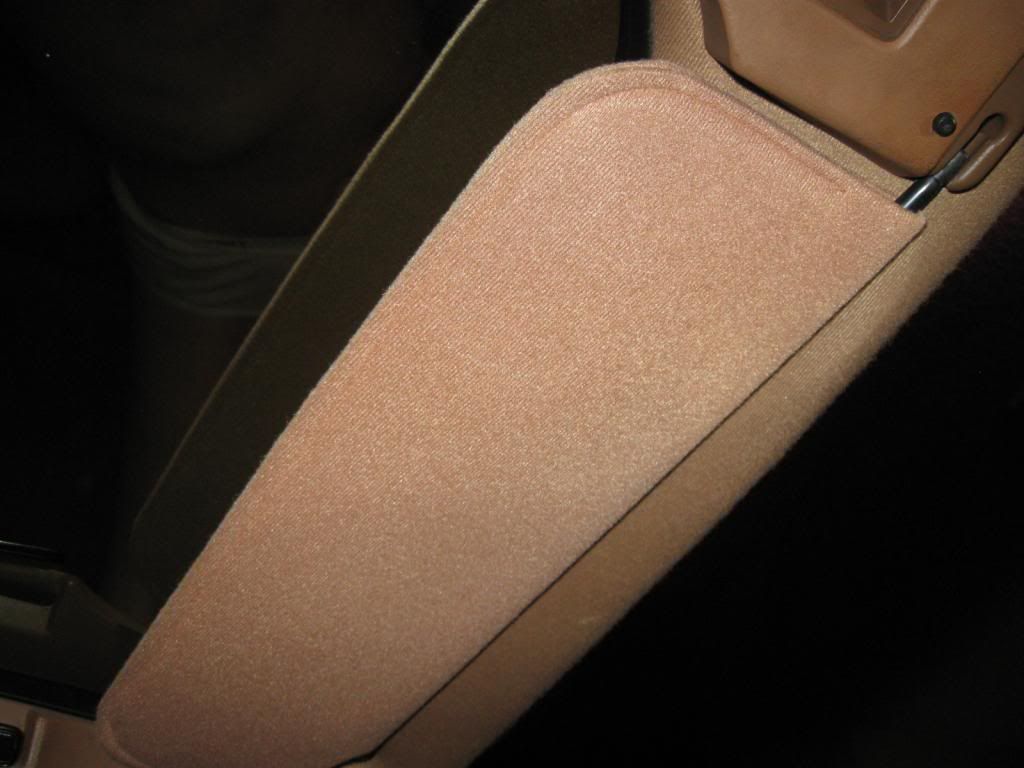

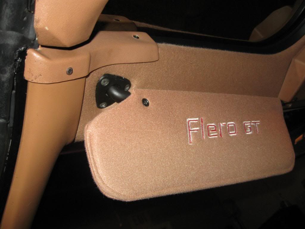

Below are pictures of my 88 CJB

Originally posted by rpro:
There is no difference between any of them. The only way they won't fit is if you have the mounting plate on the visors mounted incorrectly.
I know who made them bad boys. Still lookin good!!!!!!
And yes they are 100% the same inside and out

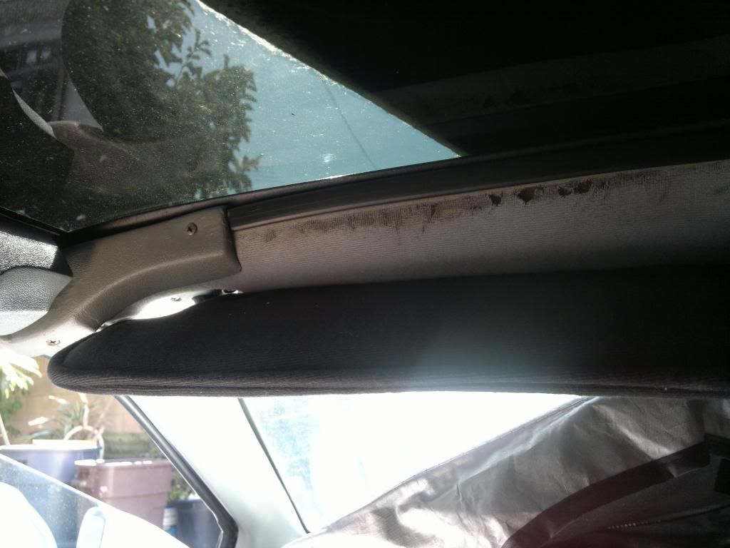

Hello,
Thanks for the quick replies. I took some shots of my current setup and am not quite sure how it differs from your pics.

Report this Post09-14-2013 08:16 PM Click Here to See the Profile for jelly2m8Send a Private Message to jelly2m8Edit/Delete MessageReply w/QuoteDirect Link to This Post
Whoever redid your headliner used way to thick foam on it.

Report this Post09-14-2013 09:41 PM Click Here to See the Profile for jaskispyderSend a Private Message to jaskispyderEdit/Delete MessageReply w/QuoteDirect Link to This Post
I believe the visors need to be mounted a certain way, so as the angle is correct. You may want to pull the visor down and rotate the mount to see if the angle is correct. Otherwise there is no difference in visors on Fieros (when it comes to mounting).

Report this Post09-15-2013 06:55 PM Click Here to See the Profile for hyperv6Send a Private Message to hyperv6Edit/Delete MessageReply w/QuoteDirect Link to This Post
I too thought something was wrong on the caps but they are ok. It was just an optical illusion.
From what I can see the padding on the headliner is too thick and should be thinner. Also the visors you have are not stock Fiero visors and are not cut right on the outer edge. The factory ones had less of an outer edge and they fold right up.
Change the visors to a FIero OE correct visor and fix the head liner and it should be fine.
There Is only one place to screw them is so changing them may be your only choice.

Report this Post09-15-2013 07:33 PM Click Here to See the Profile for ZerodragSend a Private Message to ZerodragEdit/Delete MessageReply w/QuoteDirect Link to This Post
That's actually my second set. My other set I got from the Fiero Store (I believe) and they have the same problem. That's why I am stumped.
