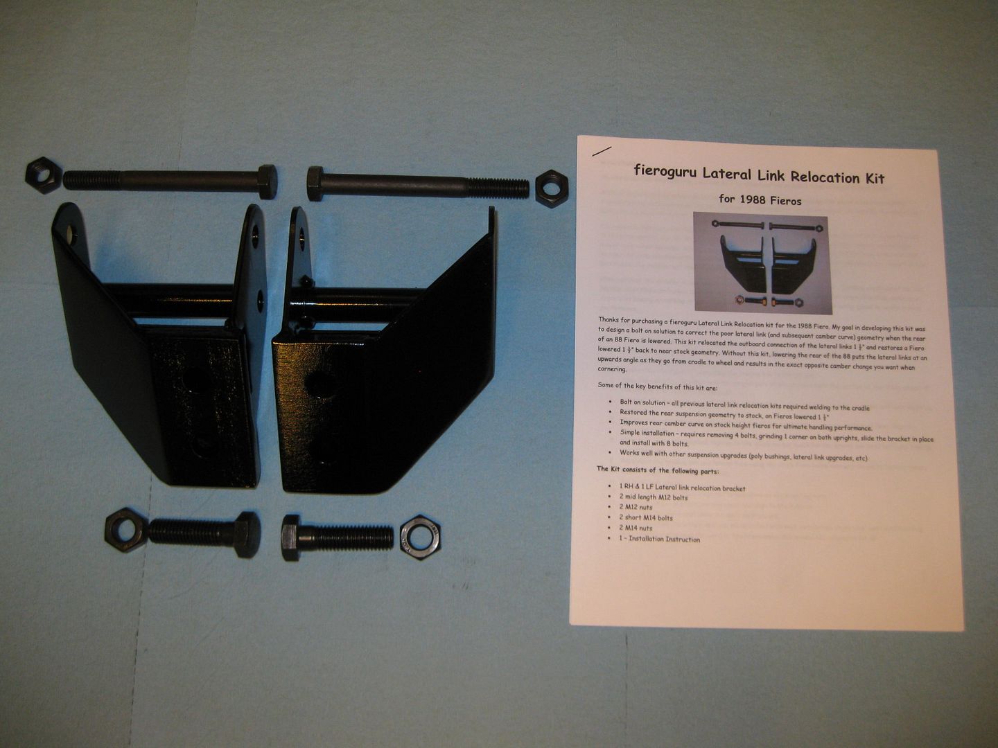

I got fieroguru's lateral link kit in last week and had time last night to get them put on. We had some issues with one of my bolts seized up so we only got one side done (passenger) side. The driver side, we are going to have to see what we can do as we don't want to break the head off the bolt. Do they sell the long lateral bolt that comes on the 88's stock if it does break by chance? I'm afraid it might and I might need it. Let me know if any of you guys with 88's have an extra you can send me, etc. Didn't know if the Fierostore sells such a bolt.
Anyways, here are (2) pics of my car without the lateral link kit on and then the second pic has it installed. Made a huge difference as my car is extremely lowered on coilovers.
Thanks again for a great product!
Without the lateral link kit:
With the lateral link kit installed:
-Amir

fieroguru
Posts: 12639
From: Champaign, IL
Feedback score:    (45)
Total ratings: 258
Report this Post09-10-2013 03:35 PM Click Here to See the Profile for fieroguruSend a Private Message to fieroguruEdit/Delete MessageReply w/QuoteDirect Link to This Post
Glad you like the kit!
I have several spare long bolts. I don't normally sell them, but if my customers need one I will gladly help them out. So let me know if you need one and I can send it to you.
Originally posted by Gall757:
Are you sure you got the right picture?
The pictures look right to me. It is a lateral link relocation kit where the link attachment points are lowered at the upright.
Here is a picture with it installed on my car:
On his pictures, if you look at the relative distance between the outer CV boot and the lateral link attachment at the wheels, you should see the difference.
The relocation brackets lower the outboard attachment points by 1 1/2". So if your car was lowered 1 1/2", it would restore the lateral links to their stock horizontal position. However, since his car was lowered more than 1 1/2", the relocation brackets help reduce the upward angle of the lateral links, but can't get them back horizontal.
I thought the same thing! I even put the pictures into a program I have here so I could toggle back and forth between them at full screen. All I saw was the camera angle changing! I did see the lower bar appear to slightly change angle, but thought it was from the different camera perspective. I guess sometimes it helps to know what you are looking for LOL!

Report this Post09-10-2013 05:21 PM Click Here to See the Profile for Gall757Send a Private Message to Gall757Edit/Delete MessageReply w/QuoteDirect Link to This Post
OK,,, I get it now!....thanks for the extra picture... 'before' and 'after' pics can be tricky.
