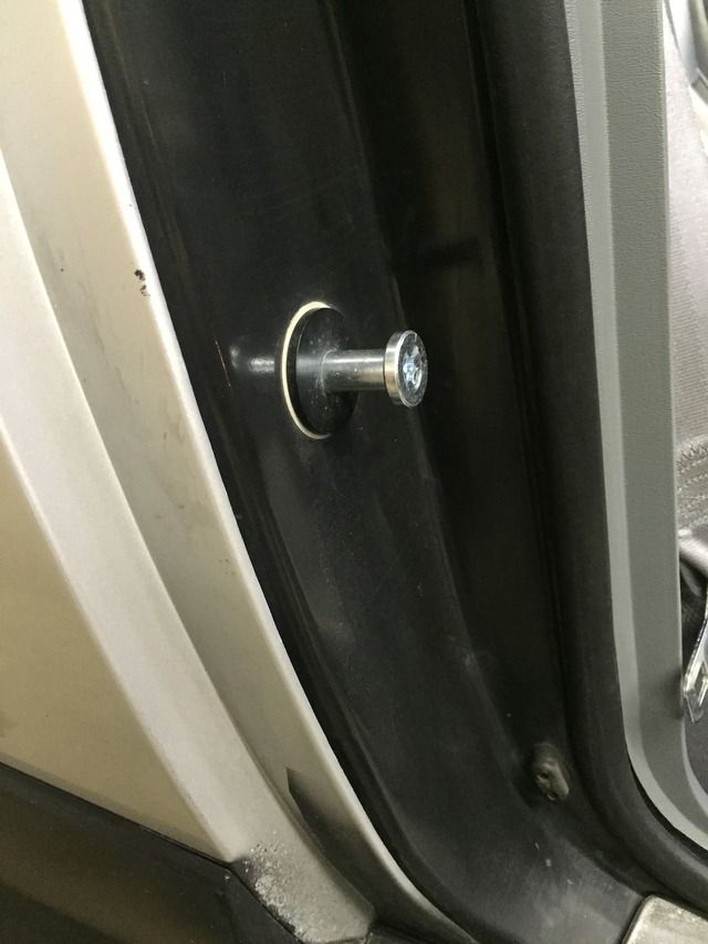

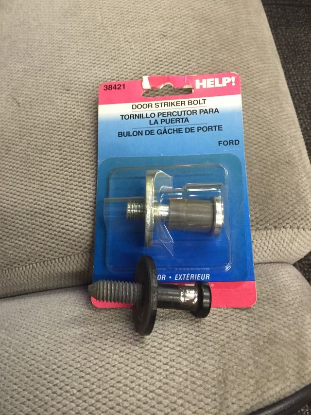

After putting more miles on the car I started to notice some significant and annoying rattles over bumps. Doing some research I found the door stricker bolts tend to wear just enough to allow the door to move around a bit. I found that if you use the Ford striker bolts from the Help! brand they fit perfectly and take up the extra slack. Just remove the plastic cover and swap the washer bolts and voila, no more door rattles!
You can see on the old striker the part where it wore down causing the movement.
Did this on both sides and the difference is night and day. There are still some rattles from the door window guides being loose but I'll address those later, kind of a pain to get to.
