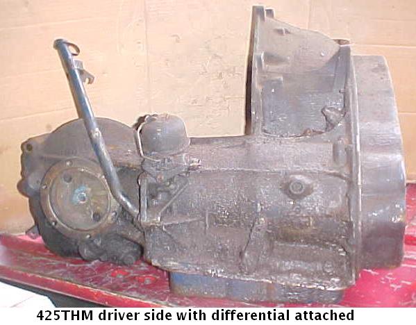

Talk to Chris Hodson on here. Here is a pic of his engine bay. He was goofing around with the headers
And his thread:
https://www.fiero.nl/forum/Forum2/HTML/111704.html

Looks like he is using the th425 tornado transmission. I knew this setup was possible within the stock wheelbase, however, I am definately wanting to go manual. Using the subaru trans it may even be possible to keep some of the trunk, although, it would end up being much shallower.

Others have done longitudinal swaps and they can be made to fit, but the transverse swap is a much easier solution and you get to keep the trunk. Also a Fiero is true mid engine as it is located between the front and rear axles. I doubt if moving the engine forward in a longitudinal application another 6" or so is going to buy you much.If you look at the install shown in this post it appears that the engine isn't moved at all.
Yes, but doesn't the tornado tranmission actually shift the axle forward rather then rearward?
O.P.: It can be mounted longitudally without a stretch because of where the axles connect to the trans. The transmissions your showing the axles would mount rearward and without a stretch, you would need to relocate the firewall inward to the cabin, reduceing space inside. I hope your not very tall, and don't plan on ever having anyone very tall in your Fiero.
Above I measured that you can gain 5" of space without losing any seat travel. My seats do not recline however.

Originally posted by steve308:
Corvair / Kelmark listed on e-bay is a 4 speed / Also way to many years ago a Kit Car manufacture in TX had a Mid engine unit that appeared to be very compact. It used a belt driven trans that allowed a longitude mount v8 to fit in a very limited space. The trans extended to the rear or the vehicle where the drive pulleys were and then belts transfer the power forward back to the axles. I think the car was called the ZARA and we have a forum member who worked at the factory. I'll keep digging and if I find it -- it may be an interesting read.
The company was Exotic dream machines out of Rancho Cordova Ca. I built the drivetrain and chassis.
We built the system to see if we could come up with a way to build a mid engine drivetrain w/out having to use the avalible transaxles of the day, in the end it cost more and would not handle the bbc we were using for testing. under hard accel the belts would "ratchet", you could feel it jumping teeth. under lower hp ratings it would work, but what's the point.
Cheers Beers n Gearz. Joe
