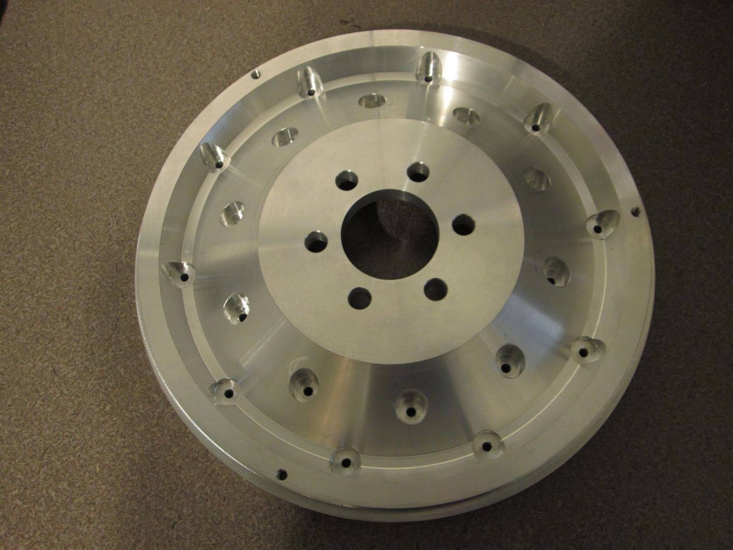

Report this Post08-30-2014 06:06 PM Click Here to See the Profile for fieroguruSend a Private Message to fieroguruEdit/Delete MessageReply w/QuoteDirect Link to This Post
So after nearly 3 years, work is underway to make this flywheel a reality.
I should have the revised quote back from the machine shop by the end of next week and will order the first production flywheel to be made. I expect 3-4 weeks for the 1st production flywheel to be ready for verification. Once I have it back, I will verify all critical dimensions and clutch/pressure plate fitment. After everything has been verified, I will order the first production run of flywheels.
A few of things to be aware of...
It is unknown if I can hold the $550 price - it has been nearly 3 years since it was quoted last and many component prices have increased.
The first batch will be LS4/F40 flywheels, but I made have a few blanks made that I could machine for other neutral balance applications (like 60 degree V6 and N*).
Once I have finalized the price I will need to know who is interested in purchasing a flywheel in the next couple of months. I am fronting all costs to manufacture these flywheels, but would like to have a decent idea of how many flywheels are needed for the first order.

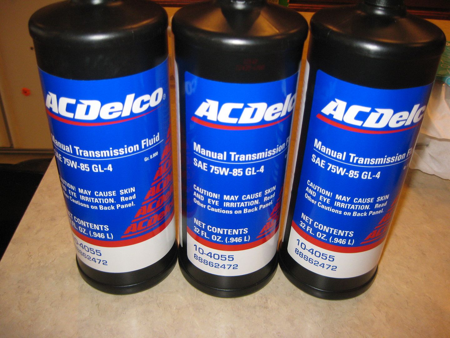

GM never recommended Synchromesh for the F40 and that is the wrong fluid to be running. The F40 is supposed to use this manual transmission oil:
75w-85 GL4 oil. Syncromesh is around 35w and too thin to provide adequate protection for the gears. Some transmissions are designed to use syncromesh and other are not. The F40 is not.
I have done a lot of testing of various fluids in the F40.
GM fluid
Redline 75w-85 synthetic manual transmission oil with motorkote friction additive (all the rave on the internet)
Royal purple Syncromesh
Royal purple Max Shift ATF
Royal Purple Max Gear 75w-90 GL-4
They all still rattled about the same, but the 75w-90 GL 4 seems to shift the best.

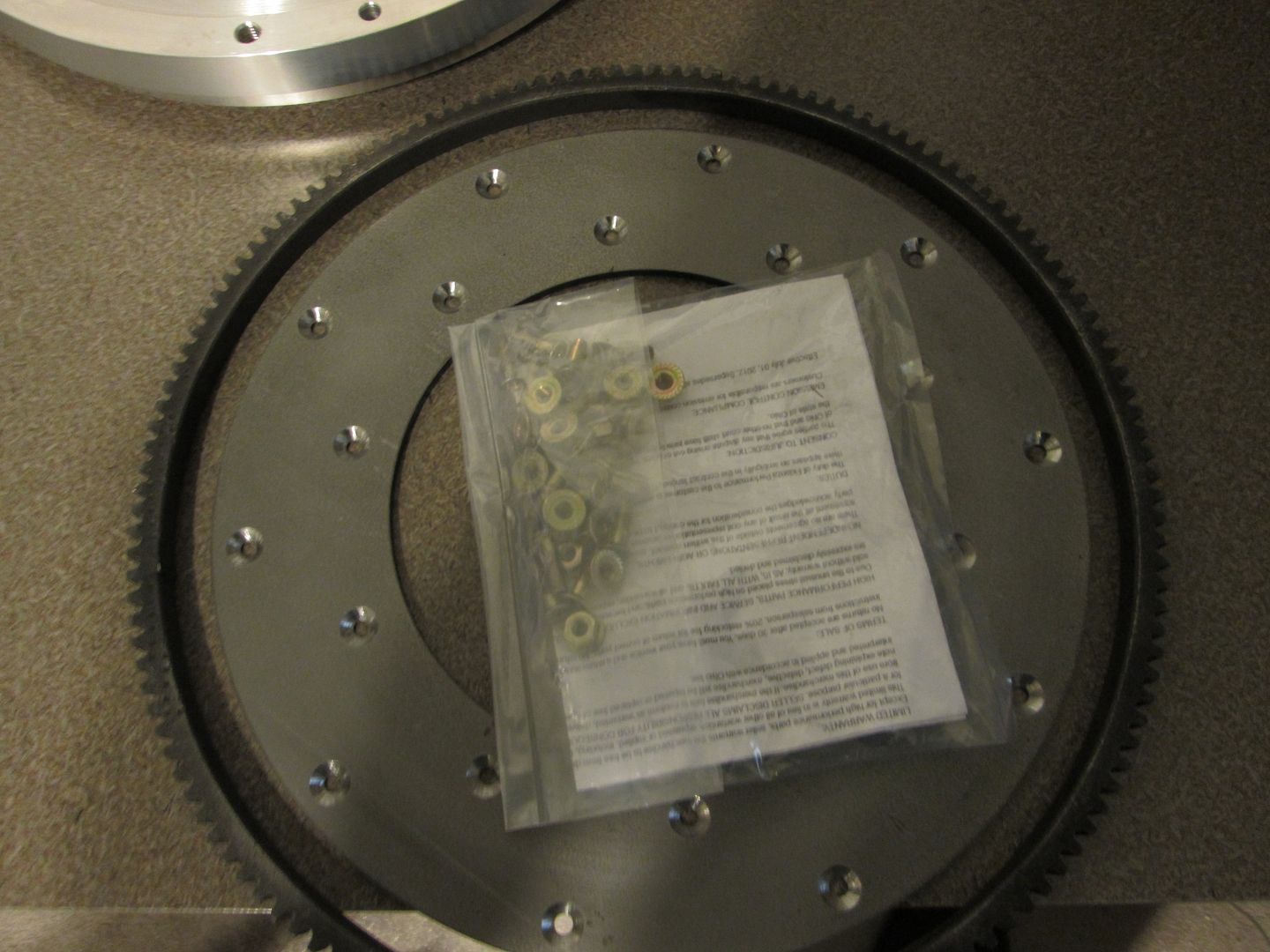

Report this Post10-24-2014 07:34 PM Click Here to See the Profile for fieroguruSend a Private Message to fieroguruEdit/Delete MessageReply w/QuoteDirect Link to This Post
It took nearly 3 years... but the 2nd LS4/F40 flywheel and the first production sample has finally been produced...
I might get around to assembling it this weekend, but I have a lot of other stuff to do as I will be traveling for my day job all next week.
