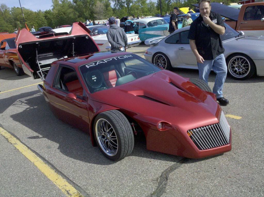

This has to be one of the most unique Fiero trikes ever frankensteined together. The taste might not be for everyone but there was definitely a lot of time and money spent creating this thing. The owner said he started with a Honda Goldwing engine and driveline then later upgraded to a sbc and auto trans.

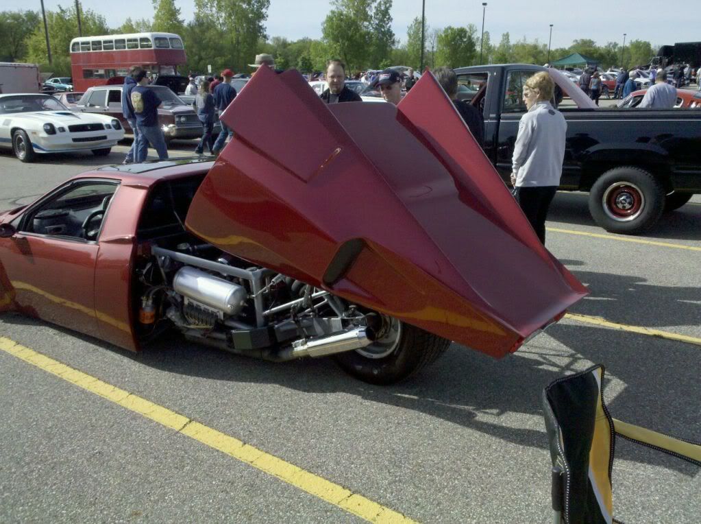

I like that, did you get any more pictures of the engine? I would love more details of how they did the install.

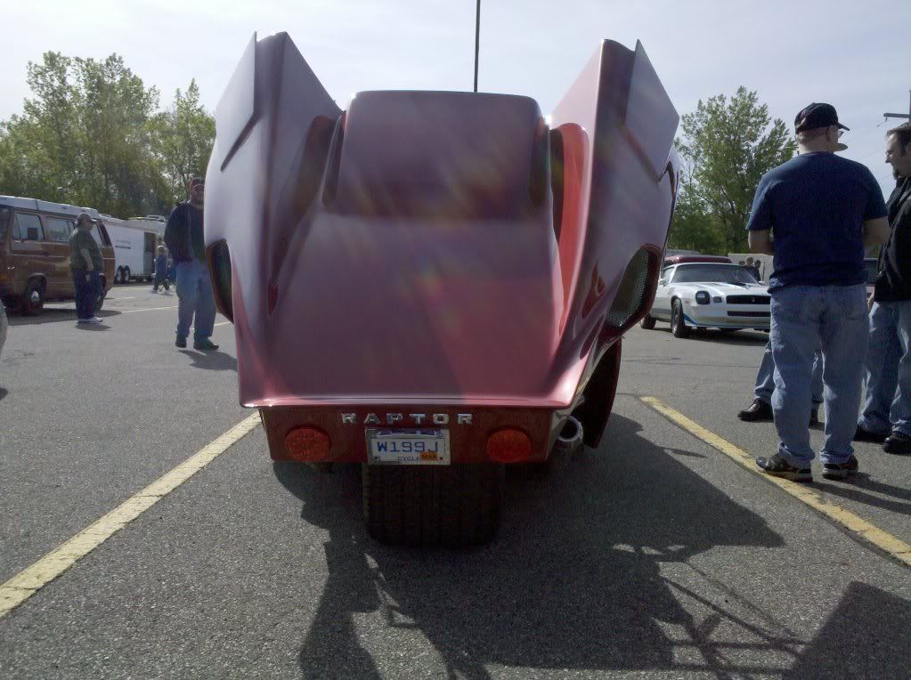

I wasn't able to get any pictures with the decklid down but Vince (snapperhead) might have taken some. He also may have some better shots of the drivetrain. The ones I posted so far are all I've got.
The bottom picture of the car's rear has the plate and its a motorcycle cycle plate.
Did you invite them to the forum?
I got a few drivetrain shots and will post them soon. I talked with the owner / designer and got the following
350 v8
125c trans with a locked diff driving a chain on the right side output shaft to the rear wheel.
Custom swingarm with dual airbags and a monoshock, Front tube control arms with airbags also.
Huge 19" wide steamroller on the back.
All custom interior.
The rear cradle was bolted at the front cradle mounts, a mid mount at the top of the doors . So 4 mounting points from what I saw.
All the work & design was the owner. The guy in the 2nd pic with hand on his chin above, nice guy I forgot his name... My brain is going all to.... well we all know where our brain goes..
Correction only 4 mounting points not 6 as I stated before

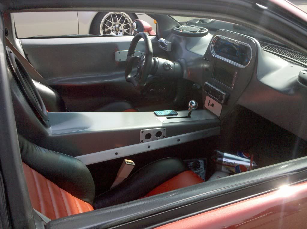

Any additional pics of the interior? The seats look like Mr. Mike's and dash seems to-be made of fiberglass. Did the owner mention anything about the over-all wieght? It must be fast?
[This message has been edited by madcurl (edited 05-16-2010).]
RyanFromMichigan
Posts: 169
From: Grand Rapids, MI, USA
Registered: Mar 2009
Report this Post05-16-2010 08:56 PM Click Here to See the Profile for RyanFromMichiganSend a Private Message to RyanFromMichiganEdit/Delete MessageReply w/QuoteDirect Link to This Post
Found one interior pic that I didn't post earlier.

Thanks for the interior pic. I see the owner uses only the best in instrument gauges--Dakota Digital.
