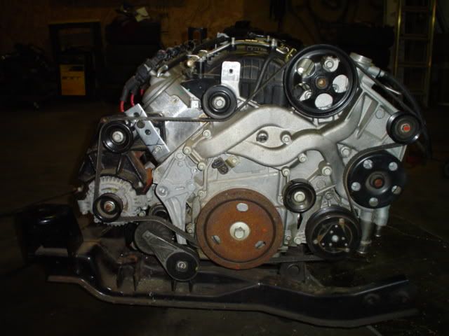

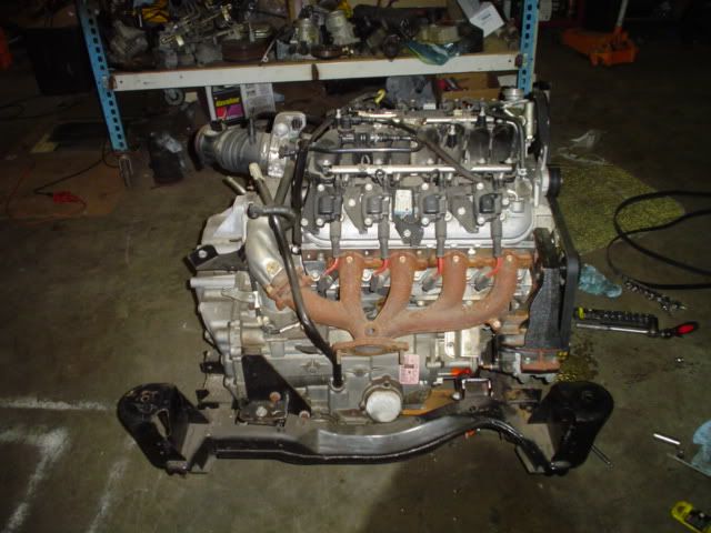

Report this Post09-07-2010 09:05 PM Click Here to See the Profile for MstangsBwareSend a Private Message to MstangsBwareEdit/Delete MessageReply w/QuoteDirect Link to This Post
Finally an update on the swap that has a few new pictures and things getting rolling on it again. This week I completed the mounting of the swap as it will sit in the engine bay. I also started working on the belt routing with the Alt mounted low. The Alt is mounted low by taking the stock mount and flipping it up side down. One hole lines up in the head and there is another area in the mount where it can be bolted down using a pinch type setup. This setup seems to work well and looks good with only a little clearance issues on the lower frame rail. For the belt routing I removed the stock tensioner for the LS4 and replaced it with one from a 3.1 motor that I have laying around. It fit nicely over the lower bolt hole of the stock LS4 tensioner setup. The belt routing showed is pretty much how it will go except for I will also use the other pulley by the crank once I get the correct belt and I might not use the pulley on the Alt mount. I plan on using the PS pump/pulley as a dummy setup being it works well for the belt routing. Now it is time to clean up the engine bay again and prep it for the engine to go back in. I plan on test fitting the engine one more time to insure everything still clears as before.

Report this Post09-07-2010 11:00 PM Click Here to See the Profile for aaronkochSend a Private Message to aaronkochEdit/Delete MessageReply w/QuoteDirect Link to This Post
Isn't that alternator/tensioner gonna be right where the axle should go? Or is it a trick of the camera because of the angle of the shot?
Looking at Jeff's Fieroking shot:
From This build thread
I may be off, but I saw that build in progress, and room there is REALLY tight...
Good luck!

Report this Post09-07-2010 11:36 PM Click Here to See the Profile for MstangsBwareSend a Private Message to MstangsBwareEdit/Delete MessageReply w/QuoteDirect Link to This Post
Good luck!
Yeah it was right where the axle would be going....I noticed that once I posted the pictures and went back out to the shop to work on it some more. I think I have the issue solved though with a smaller pulley and re-postioning the tensioner closer to the crank pulley. There is clearance between the CV boot and tensioner now but not a whole lot. Going to look for a smaller pulley for the tensioner to see if I can get more clearance. Also the CV boot is the issue so I might be able to replace it with a shorter rubber boot for more clearance. If all else fells I will go back and find another place to add the tensioner...

Report this Post09-08-2010 01:09 AM Click Here to See the Profile for aaronkochSend a Private Message to aaronkochEdit/Delete MessageReply w/QuoteDirect Link to This Post
Any chance you could fit the GXP tensioner? That spring is really beefy, and you could go from the bottom of the crank pulley over the tensioner, back down and under the alternator, and then back up...

Report this Post09-08-2010 01:11 AM Click Here to See the Profile for aaronkochSend a Private Message to aaronkochEdit/Delete MessageReply w/QuoteDirect Link to This Post
aaronkoch
1643 posts
Member since Aug 2003
It would also help give a bit more wrap on the crank pulley, I know Jeff is still fighting a bit of a squeak, and his wraps around it pretty good..

Report this Post09-08-2010 08:56 AM Click Here to See the Profile for MstangsBwareSend a Private Message to MstangsBwareEdit/Delete MessageReply w/QuoteDirect Link to This Post
I tried everyway possible that I could think of to use the stock tensioner but nothing worked. Thinking of running a GP 99 up Alt like Don Kraus did to make things easier.
