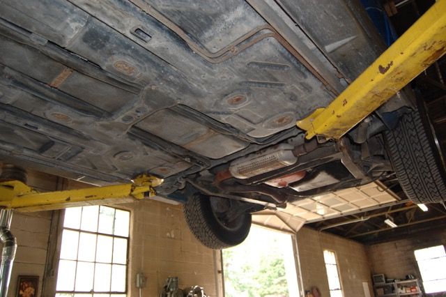

I would, but look at these pics of the undercarriage....... headlights, done that already, a/c..... another task I have been through recently.... heck, I just spent the day today at a bone yard picking out Pontiac radios.... 3 to be exact..... lol, this is fun, like someone said, the tail lights alone are worth 1/3 of the cost of the car.
I am serious about this and am persuing this like no other GT previously.
I am finding out '88 parts are rare and hard to find, so this is a much easier project for me.
I really do not mind the cost of the '88 parts, it is just the finding them that is out there.
Proper exhaust, brakes, tie rod ends, etc. all one off......

Wow, talk about a motivated seller! In reality, 95% of our cars all need some work here and there. So I go into a fiero purchase expecting brake issues, headlight problems, etc. However, this particular car's biggest issue seems to be clear coat. Hit the underbody with aerated ATF and leave it be. Hope it goes to a loving home like yours!!

Hmmm... looks like the RH tie rod end locknut is about a nut thickness away from the ball joint.

If it was me, I would pass on the car unless you wanted to buy it just for parts. The inner trunk rust holes are always better on the inside of the trunk than viewed from the outside rail section, so you will have to pull the rear section at some time and do some significant rust repair. There are also other things that just raise some concern as well.
Tie rod jam nut out of place - this is more of an indication that when work was done, it wasn't done with a high degree of precision. What other nuts/bolts were left loose?
Missing one of the front stabilizing supports - same comment from above... :
Orange oil pan... engine has been out at some time.
Then the lift points being used on the chassis just make me cringe, as do the multiple locations of kinked coolant tubes in the pics above...
From the pics on craigslist...
Portions of the car have been repainted - over blue over spray on the mounting bracket for the decklid vents and on truck seal... again more of an indicator of the precision of the work.
Black rear spoiler... another sign of repainting.
Broken ground effect piece at DS rear wheel... it is in an odd place...
So for me when I review this car, lots of things are telling me that it will potentially have more headaches than I want to deal with. Tally up the estimated cost/time to fix them, add that to the purchase price, then shop for a better condition one at that price point. If you find one you will be time and $$$ ahead.
Orange oil pan... engine has been out at some time:
Then the lift points being used on the chassis just make me cringe...
