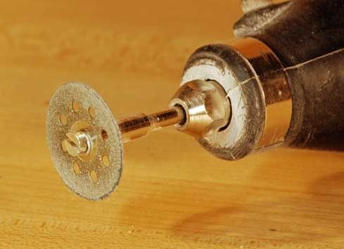

Not much help but this??
Last ditch effort.
edit...oh NM
[This message has been edited by weloveour86se (edited 08-10-2013).]
Last ditch effort.
edit...oh NM
I did that ( well, reciprocating saw ) on a door knob once on my front house door. It was 'pressed' on and there was no way to get it back off without cutting it.. made a simple job a real pita..
