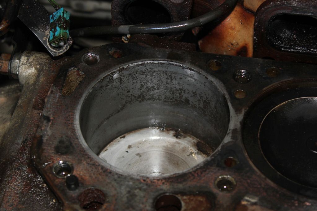

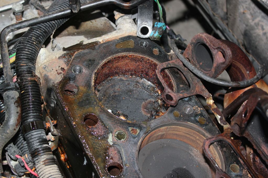

History of the engine....I got the car out of a field, I made it run, It caught fire, I used a powder extinguisher, rocker arms and the top of the head is rusty and the number 4 cyl was rusted so bad the engine seized. some handy work later I have rust free cyl walls and a rotating engine.

Got most of it out....Gonna wait until work to get some magical stuff that will get rid of the rest of the rust. Im just happy the walls are not pitted and there are no ridges. Some would just junk the motor....I like a challenge.

I'd bet $ that cylinder has some broken piston rings.

Im betting it wont without getting into too much detail. When I put the head back on I will do a leakdown. Either way, its just a duke....For the cost of a hone tool and a set of rings I could get a running duke with low miles.

If the car is relatively rust free, and the frame is solid, and the body isn't too torn up, a decent 4cyl Fiero is a really, REALLY great commuter car that you can actually enjoy having. Being that it's an 84, there's plenty of cheap parts for it too. I see that you cleaned up the cyl walls... they look really good. First thing I notice of course is the LIP that has been created by the piston rings grinding away at the side. I've actually done something similar on an 84 Fiero, and the lip on my piston ring looked a little bit worse than yours (from what I can deduce from the picture).

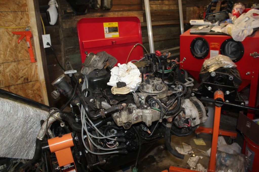

Allow me to show you "plan b". I didnt think the heads would swap.....interesting, that just gave me a better reason to get it done. I want this car as a commuter because of the mpg it can get. I want to get the block decked and get singh slashes in the head but the bottom end would blow out. Anyway, here is plan b
