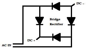

Originally posted by dratts:
Right! Ac in, ac out. You can't run a 12v dc radio on a transformer.
??????????? all right you confused me there. All of my 12 volt dc electronics for cars work on transformers. They say transformers right on the cases. I have 12v dc tvs and radios all over the house and garage running on 12v dc transformers and have been for years. So your saying im doing the impossible ? If im not mistaken even your home furnace blower motor is 12 volt and running off a 120 v ac to 12 v dc transformer. They run for 20 years. In a power outage, you can run your furnace off a car battery.
dratts
Posts: 8373
From: Coeur d' alene Idaho USA
Total ratings: 118
Report this Post08-20-2012 12:08 PM Click Here to See the Profile for drattsSend a Private Message to drattsDirect Link to This Post
There is no such thing as a dc transformer. A transformer requires ac voltage. If you add a rectifier it can turn the output ac to dc. At that point it is more than a transformer. It is a dc power supply at that point. I don't know why so many smart people are arguing this point. It's basic electronics.
Marvin McInnis
Posts: 11599
From: ~ Kansas City, USA
Total ratings: 227
Report this Post08-20-2012 12:50 PM Click Here to See the Profile for Marvin McInnisClick Here to visit Marvin McInnis's HomePageSend a Private Message to Marvin McInnisDirect Link to This Post
100% correct. This is indeed very basic electrical theory and (for those who don't like theory) practice. A transformer is just a device with two or more inductively-coupled windings ... or even a single tapped winding ... usually coupled by a core of magnetic material. They are, by definition, AC in / AC out devices. The current through the primary (input) winding must be AC for the transformer to induce any voltage or current in the secondary (output) winding. If a device has DC in or DC out, it's more than just a transformer.

Ok, so if I understand what your saying, all these 'boxes' that say transformer on them are incorrect ? Theyre not transformers at all. How come my voltmeter shows them as 12-13.5 volts DC. If I set my meter to read AC volts and connect the probes, it reads zero. So according to the meter, it is putting out DC (12+) voltage and no (zero) AC voltage. Just asking, not arguing.
Rallaster
Posts: 9105
From: Indy southside, IN
Registered: Jul 2009
Total ratings: 84
Report this Post08-20-2012 05:51 PM Click Here to See the Profile for RallasterSend a Private Message to RallasterDirect Link to This Post
It does have a transformer in it, but it performs more than just a transformer. It also has circuitry(rectifiers/diodes) to convert the AC output of the transformer into the DC current you're seeing with your meter. The transformer itself only converts the high voltage AC to low voltage AC and the output is converted into DC by way of the additional circuitry. The labeling isn't necessarily wrong, it's just incomplete.
[This message has been edited by Rallaster (edited 08-20-2012).]
Khw
Posts: 11139
From: South Weber, UT. U.S.A.
Registered: Jun 2008
Total ratings: 134
Report this Post08-20-2012 11:07 PM Click Here to See the Profile for KhwSend a Private Message to KhwDirect Link to This Post
Or vice versa converting the high AC voltage into an even higher AC voltage. For instance a transformer to power neon lights.
A transformer is just seperate sets of windings around a core, that's it nothing more. The number of windings in proportion between the 2 or more sets of coils determines the voltage output based on the input. More windings on the output side results in increased voltage, less windings on the output side results in decreased voltage (if I remember correctly). Also, the thickness of the conductors used will determine how much amperage the transformer can deliver. All a tranformer can do by itself is convert AC to AC, with a bridge rectifier or the use of diodes, the AC output can be converted to DC, but those are seperate components. There will be nominal voltage loss from the bridge rectifier or diode, but probably not enough to measure without a osciliscope. The bridge rectifier or diodes are not transformers, they do not in any real substantial way change the amount of voltage they are given, all they do is convert the AC feed to DC.
If I remember correctly, elctronics courses were several years back, that is the configuration for a bridge rectifier. It's 4 diodes in one casing. Note it is a bridge rectifier, not a transformer, that makes AC voltage into DC. What people are saying, as in the quoted post, is a transformer does nothing but convert AC to AC, it's a bridge rectifier or some diodes that converts the AC to DC.
Also, just a note, if you feed DC into a transformer, you end up with a electro-magnet.
What you have is refered to a 'wall transformer' which has inside the 'box': a transformer (step down), bridge rectifier and a regulator. It is essentially an AC to DC converter. It is not strictly a transformer per say - it's just about the terminology and what has become the accepted name to call the device.
If you walk into any electronics store and ask them for a 'transformer' so you can charge your phone that is what they will sell you - it has become the accepted 'description', but if you do a search for 'transformer' on Digikey (or any other electronics parts supplier) you will get listings for only just the transformer ('wall transformers' will also show up, since transformer is part of the name - you have to search for 'wall transformer' to only bring up those boxes you are talking about).
It is like saying electronics above - on one hand it refers to a component like a stereo (or tv) where as on the other it refers to the actual parts inside that makes up the stereo.
I was speaking to his specific case, which, if I understand you correctly, my description was correct.
Just for reference, I really only know enough to get myself into trouble. I can identify most of the specific components, but I am largely unable to explain exactly what they do, let alone how they do it.
Excellent explanation.
A transformer is just seperate sets of windings around a core, that's it nothing more ... All a tranformer can do by itself is convert AC to AC, with a bridge rectifier or the use of diodes, the AC output can be converted to DC, but those are seperate components. There will be nominal voltage loss from the bridge rectifier or diode, but probably not enough to measure without a osciliscope. The bridge rectifier or diodes are not transformers, they do not in any real substantial way change the amount of voltage they are given, all they do is convert the AC feed to DC.
Also a good explanation. One detail correction, though. AC voltages are usually expressed as RMS voltage (average effective "heating" value) rather than peak voltage, but the DC output from the bridge rectifier will be the AC peak voltage (less two rectifier diode voltage drops ... ~1 volt each). For sine wave AC, the peak voltage will be ~1.4 (actually the square root of 2 = 1.414...) times the RMS voltage. Thus the DC output from a "12 volt RMS" transformer plus a bridge rectifier will be about 15 volts. Similarly, if you run standard power line 120 VAC through a bridge rectifier the DC output voltage will be ~168 volts.

Just to wander around some more. Nobody has mentioned that we're talking "full wave" bridge rectifier here. You can get dc out of a half wave rectifier too. Just not as much.

A little off-topic but I always wondered how a transformer could change 60 Hz to 20 Hz in a telephone ring supply.
Finally found the answer:
