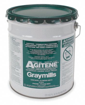

Originally posted by Silentassassin185:
http://www.grainger.com/Gra...209020&cm_vc=IDPBBZ2
Parts Washer Cleaning Solvent, Super Agitene, Container Size 5 Gal, Color Dark Green, Flash Point 141 F, Removes Grease and Oil, Non Hazardous Formulation Includes Lanolin To Reduce Skin Irritation and Chapping
