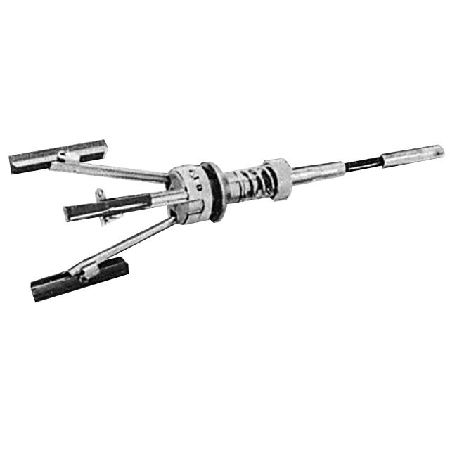

The piston on the aluminum bore blocks is plated (hard chrome, I think) and if the coating gets scratched, the bare aluminum bore and piston try to stick together, causing worse scratches. Go ahead and get a new piston, connecting rod and set of rings.

I agree with the cylinder hone idea. You can get one very cheap at your local auto parts store and it attaches to a hand drill. As mentioned above, you go up and down while the tool is running to create a cross-hatch pattern:

A cylinder hone is great, but unnecessary in this case, and can actually cause more harm than good when used improperly on an alloy cylinder (which is relatively soft compared to iron). You can easily go off kilter and dig a stone into the alloy cylinder walls.
A hundred years ago, my first job out of high school for a number of years was rebuilding air-cooled engines. When the cylinders weren't being rebored and oversized, we just used emery cloth (I forget what grit) and removed the glaze from the cylinders by hand being careful to produce a cross-hatch pattern. The new rings would seat perfectly. (Make sure to also sand/hone down the ridge at the top of the cylinder a bit.)
Oh crap, I missed that part. I was just looking at the picture and assumed there was a steel liner for a cylinder. Never mind the hone idea
