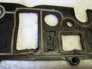

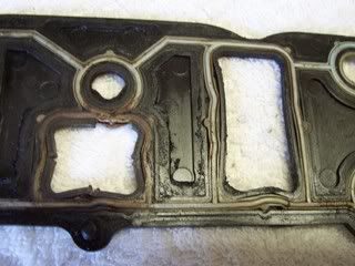

They can leak under pressure, and feel dry when not.
How many miles on the GP? This is what the LIM gaskets looked like on my 99 GP GTP with 100K miles. It would be hard to start and white smoke billowing out the exhaust if it sat for a week.

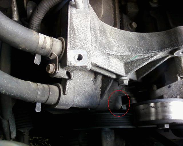

Well, yesterday kept on raining so I'm back at it today.
Snapped a pic. I can only see one 90* bend. Where is the other one?
EDIT: I circled the one I can see in red.
[This message has been edited by TheRealShadowX (edited 09-30-2011).]

1fatcat
Posts: 1519
From: Zimmerman, Mn
Registered: Dec 2010
Report this Post09-30-2011 11:10 AM Click Here to See the Profile for 1fatcatSend a Private Message to 1fatcatDirect Link to This Post
I think you are going to need new LIM gaskets.
Also, the UIM can develope a leak aroung the egr stove pipe. It melts the plastic UIM where the egr stove pipe passes through and opens the coolant port in the UIM to intake vacuum, causing the coolant to be burnt in the engine and sometimes hydrolocking the engine durring start up. There is an updated LIM with a smaller stove pipe that stops this from happening, you may already have the updated LIM and won't need to worry about this.
When you do LIM gaskets, it is recommended to do the plastic elbows at the same time. They can be accessed by removing the alternator bracket. Make sure to get all of the old elbows out because they usually break off and leave a piece behind in the hole.
Edit: The other elbow is kind of behind and under the belt tensioner pulley.

Report this Post09-30-2011 11:44 AM Click Here to See the Profile for TheRealShadowXSend a Private Message to TheRealShadowXDirect Link to This Post
Ugh, yeah probably going to need new gaskets.
I found the other elbow, it was right in front of me lol.
I'm off to get some of that mechanics dye to try and track down the leak. One of the elbows was wet and has clearly been leaking but I can't get it to leak on cue it seems.
