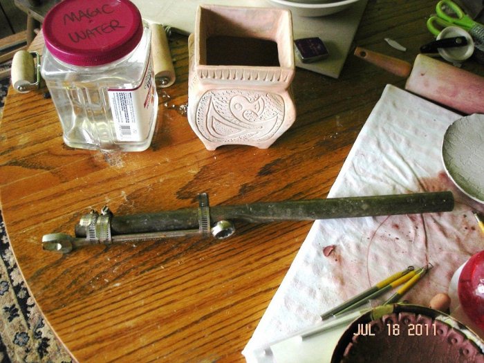

We were changing an outer tie rod end at a friends today. And the sucker was a biatch to unscrew. So we took a crows ft the right size and a hose clamp along with a 6” extension to a ½” impact gun.
The result was this,
It worked quite well, we did have to tighten the hose clamp once. But it got that sucker out in record time. And the new one back in, in record time.
Do they make a tool for this? I have never seen one.

yes they do. It is basicly a large socket with a notch in the side. You slip it over the end of the tierod with the taper shaft in the slot.

Me ? I would have used a pipe wrench. Not knocking though your ingenuity but, , questioning if you really do have a hatred for engineers, .

We had a pipe wrench on the inside to prevent the inter tie rod from having to much stress. Then we put a 4’ pipe on the tie rod end stud and had all we could do to get it to turn. We PB blasted the crap out of it, hit it with hammers and more but the dam thing would not loosen up. Even a 2’ pipe wrench wouldn’t budge it.
So we made that with what we had on hand. If we had been working at my place I would have just cut a slot in the appropriate size socket.
Tell me you haven’t made a redneck tool? And if you have lets see it.
The beer was in the cooler.

Originally posted by Wolfhound:
I'm more curious/intrigued by the container of "magic water"......what's that all about? )
What do you think powers red neck tools? you probably thought the fuel tank was just an extension on the wrench.
Actually, It's a water solution containing sodium silicate and soda ash. It;s a wetting agent for joining clay parts in hand-built pottery.
It makes the clay plates slippery so they flow together at the joints and don't crack when fired. Like the mitered corners on the Hopewell culture reproduction to the right of the container. I don't know who named it magic water but it's been called that a long time.

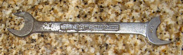

I just found one of those redneck wrenches at a garage sale!
Weeeellll, you're supposed to stop before you break the wrench. That's what PB Blaster and breaker bars are for!

It does give me a chance to try out the Sears warranty and maybe get one of their new Chinese wrenches.

That's a craftsman wrench, should be able to return that for a brand new one. Wouldn't make as good of a conversation piece though lol
