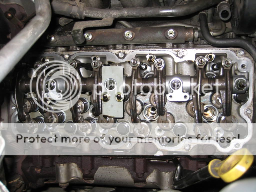

My metro has a valve tick so I pulled the valve cover off, but can't see any problems? Can anyone find anything wrong in this pic?

Assuming that it truly is ticking from the valves, I would guess that one of your hydraulic lifters may have an issue. I don't know that much about the Metro motor but that usually is the case. I was going to say one of the rocker arms may be out of adjustment but even if it was slightly off, the lifter would compensate to an extent.

A tick is usually an adjustment. Find the correct valve adjustment for the engine and give it a try. Your lifters, like the man said, could also be the problem, but chances are it is adjustment only.

It looks like the ends of the rocker arms are getting hot, color. I don't think its the case because there is a plate that pushes both exhaust valves and that would have to get hotter to discolor them so. Loosely adjusted valves make a sewing machine sound so I'm going for the lifter R&R. Go to a sound site and see if you can hear different engine sounds to isolate the noise. If it is a lifter replace them all. Mike

That sure is a clean looking motor-how many miles are on it?

That is, without a doubt, the weirdest cylinder head I've seen. But I don't get out much. Although I thought all Metros were overhead cam.
WAIT! That's it! Your camshaft fell out!

Aren't they hemispherical motors?
Or is that just the sprints or whatever the suzuki made?

The carburated (pre-88)'s are hemispherical heads.
Edit: Pushrod? wtf? Doesn't look like the Suzuki Swift/Geo Metro engines I know...

Whatever that thing is that's hitting the valve stem appears to be installed in the correct orientation.

Ok, I'll be honest with you guys. This is NOT a geo engine I was just kidding, seeing who would spot it first
This is one bank of a duramax diesel
Edit: Oh, and there is no ticking. It's an injector job.

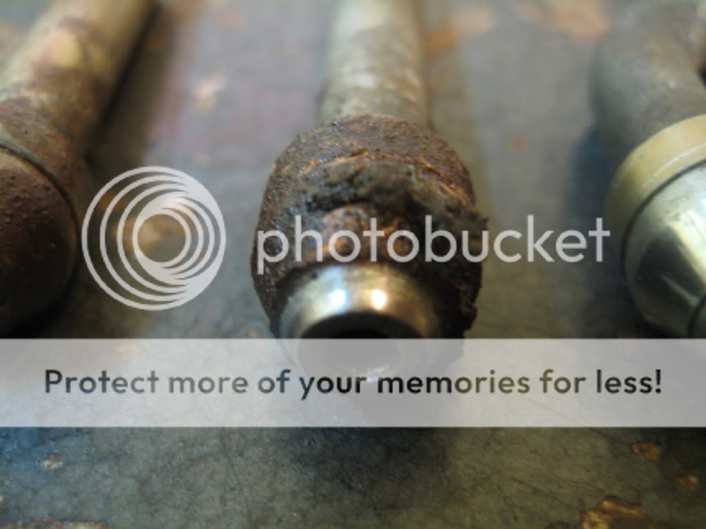

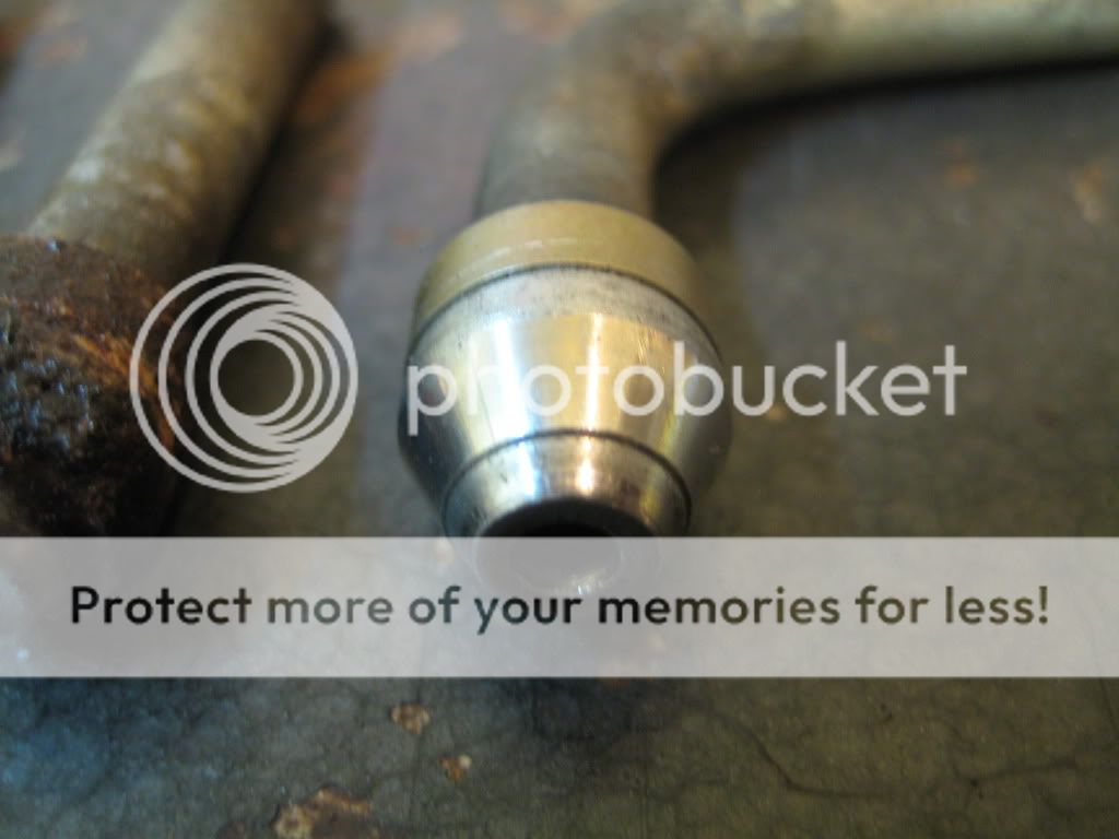

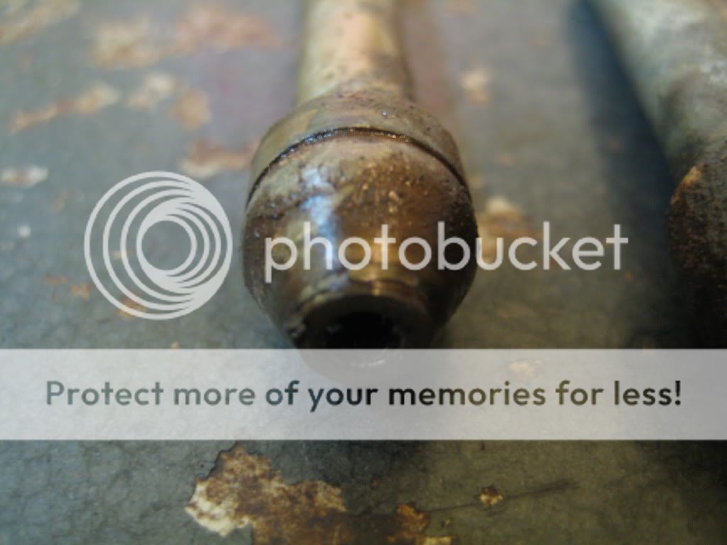

Are you doing a factory injector or a upgraded injector?
OEM parts, new pipes too (spendy buggers).

Have you checked BD or ATS? sometimes they are cheaper than stock.
Never heard of them. Do they have a web site? I paid 245 ea for the injectors and about 100 ea for the high pressure pipes....all x 8

Here's what a good pipe end looks like. This system runs a max of 23,500 psi.
And here's a couple of rusty ones
