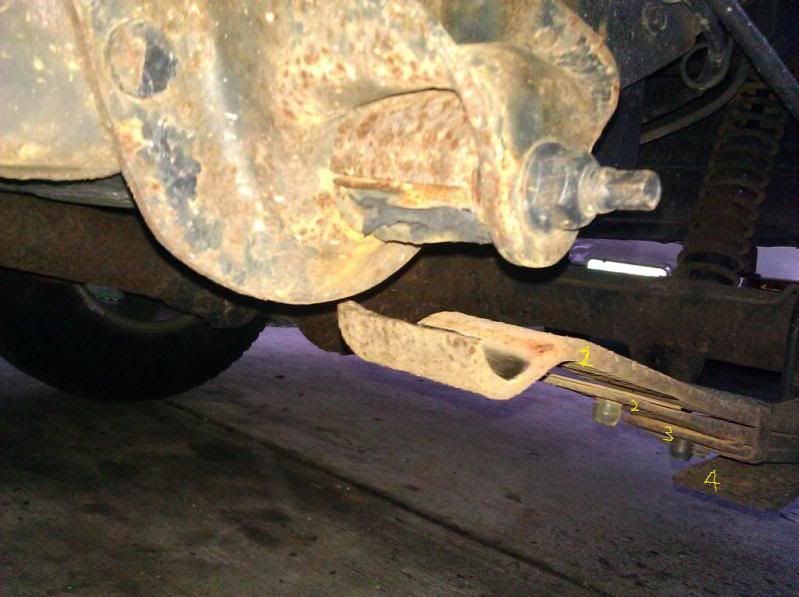

Our 2000 Dodge Dakota has a broken leaf spring on the driver side, it broke where it mounts to the frame in front of the rear wheel, and it just after where the spring starts to bend around in almost a complete circle. What is the best way to fix this? I didn't find any new ones on RockAuto or Autozone, so I could either pull one off another Dakota at Pull-a-Part, or have it welded.
Thanks
*snip*
Thanks
Matt
You will have to go the pick-a-part route if you can't find a vendor for a new one. The Dealer will probably be able to get you a new one.
DO NOT weld it. It is spring steel and the weld will not hold. I mean yes, you will get the weld to stick and the 2 pieces will be one again but the temper of the steel will be changed and the weld and steel near the weld will become crystalized (the carbon in the steel will crystalize due to the heat) and the result will be very brittle steel that will fracture and shatter as soon as you hit a bump in the road.
I am assuming by your thread title that it is the spring itself that is broken, not the shackle/hanger.

It broke where it mounts to the frame.....That would be the hanger......
Clear up some confusion. Is this the broken part?
He says in his description:
"it broke where it mounts to the frame in front of the rear wheel, and it just after where the spring starts to bend around in almost a complete circle."
Looking at a leaf spring, the circle is part of the spring that rests in the hanger with a bolt going through it. If it broke on that circle peice, that is the SPRING.

The dakotas had a problem with the springs/hangers. If the leaf spring broke in half then that is a way easy fix.

Wow, was not expecting this much attention! I have since taken a picture of it. This is with it jacked up. As you can see, it is very much the spring that has broke.
Yes I now get the DO NOT WELD point, should of thought of that, Doh!

Also, I noticed on the webpage tuzzi provided that the correct (year and model wise) replacement leaf springs have 5 leaves compared to the current 3. I understand this will increase load capacity, but would there be any differences in handling or ride stiffness with the extra leaves?

Are you sure? It looks like in the picture I can see 4.
The image on Antuzzi's link is probably a generic image. It looks to me like in the picture you have 3 full length springs and atleast 1 helper spring. The helper spring is still counted as part of the whole spring pack.
Like this one from a Dodge Dakota, although I'm not sure of year. It has 3 normal leafs with 1 helper for 4 leafs.
Granted that still doesn't get you to the 5 leafs his original link shows. Curious, I would think a 4X4 would use more leafs then its 2WD counterpart.

Report this Post06-18-2011 10:03 PM Click Here to See the Profile for mattwaSend a Private Message to mattwaDirect Link to This Post
Yea your right, I forgot about the helper spring. It is 4, you are correct. Those cheaper ones looked interesting however.

Report this Post06-19-2011 01:13 AM Click Here to See the Profile for ZebSend a Private Message to ZebDirect Link to This Post
I would weld it
I'm sure you would. And a lot of guys can. But to do it correctly, annealling the spring, welding, and re-heat-treating, quenching, and tempering to restore the correct metallurgy? Very few people have that knowledge, or the correct equipment to do this kind of work. But technically, it could be done. For a RIDICULOUS amount of money.
We both are aware, Jake, that all that stuff has to be done. I just know I have no idea how to do it!
Exactly! For all that expense, just buy a new one.

Report this Post06-19-2011 04:45 AM Click Here to See the Profile for Jake_DragonSend a Private Message to Jake_DragonDirect Link to This Post
You are doing the right thing, if youre going to keep the truck then replace the spring.

Report this Post06-19-2011 11:48 PM Click Here to See the Profile for weaselbeakSend a Private Message to weaselbeakDirect Link to This Post

Report this Post06-20-2011 10:30 AM Click Here to See the Profile for FirefoxSend a Private Message to FirefoxDirect Link to This Post
I also recommend replacing. Also remember that you have to replace in pairs.....you cannot do just one side.
Well it's not that you have to replace them in pairs, but it's a good idea to do so, and most likely should be done.

Report this Post06-20-2011 04:55 PM Click Here to See the Profile for FirefoxSend a Private Message to FirefoxDirect Link to This Post
Really?
The truck is 10 years old and springs sag with time. If you install just one new spring you'll have a noticably higher stance on one side of the truck and that'll throw off the steering and suspension. You don't replace only one spring on an older vehicle. If you broke a spring on your Fiero would you only replace one? Even though us Fiero owners are cheap as hell you don't replace just one.
I usually try to offer the proper repair techniques. If you want to replace only one spring, be my guest. It's not the proper way.

Report this Post06-20-2011 06:08 PM Click Here to See the Profile for 84fiero123Send a Private Message to 84fiero123Direct Link to This Post
Don’t do it, have it welded or weld it yourself. As a welder I have in the past welded one or two. Never wanted to, and always reinforced the weld with another leaf spring over the broken part. Surprisingly that have held for years.
You can’t do this in your case so brake down and buy a new one.
And yes everyone whop has said not to weld it has been right, it is never something that should be done, for the reasons already stated.
Really?
I have been down that road before and i agree, replacing one just means you will go back not long after and do the other .. and depending on the car and its age, the other 2 as well..
Really?
Oh ok, you are referring to brand new springs, then yes that is certainly the right way to go. I was talking about used springs.
