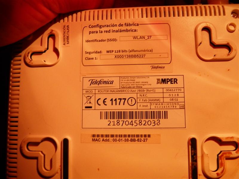

I'm not sure what you mean John, but here is a photo of the bottom of my router. I put in the WEP Key as shown:

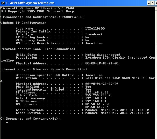

And this is a screenshot of IPCONFIG/ALL for this laptop:

You try other devices using WEP and with that key? If it is a key....
You're force to use that router? I would get a better one.... Return that one if its rented.
WEP is "dead" for security. If you are using any encryption, look like default is none, then wep is the worst.
Router IP address is 192.168.1.1
Try IP address in browser address bar.
google: router inalambrico telefonica password
first result: www.dslreports.com/forum/r1...-Telefonica-Kit-ADSL
Router
login: 1234
password: 1234
If/when you get in
Change router password. Write It Down in several places.
Change WEP\none to WPA or better, WPA2
Change WiFi Key... 15-20 at least with character, number, and symbols.
See link above... the2nicks and others live in Spain
(Jurassic Park)
The Ogre's Fiero Cave (It's also at the top and bottom of every forum page...)
[This message has been edited by theogre (edited 03-07-2011).]
