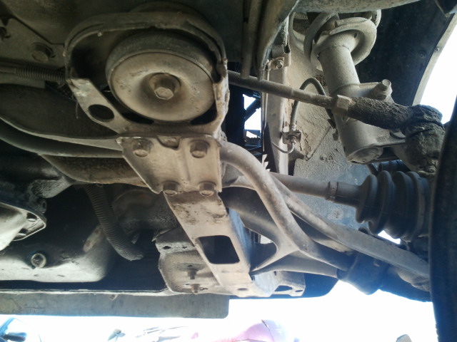

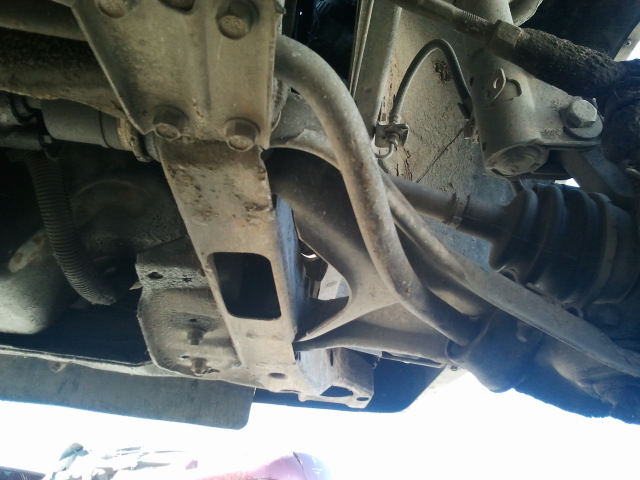

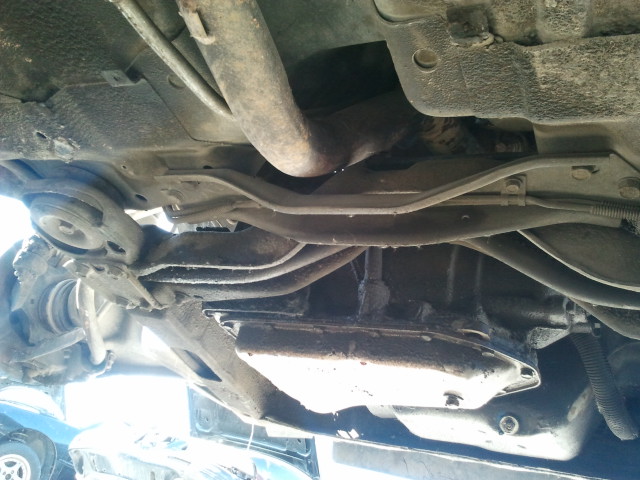

Report this Post02-11-2011 02:11 PM Click Here to See the Profile for Quad RaiderSend a Private Message to Quad RaiderDirect Link to This Post
OK. I took photos of the Citation cradle in the junkyard, but then TWO separate blizzards hit Oklahoma dumping more than three feet of snow here. Between having to cover the blizzards at work, and not having much time to talk to IT, it took me a while to figure out how to post photos, but here goes:
As far as I know, the Citation is still sitting in the salvage yard waiting for my attention. There's also a 6000 STE which I understand has parts that could help me change the Fiero's rear hubs, right? (maybe I should make that another thread)
Anyway, how does this sway bar compare to the '87 Fiero cradle? Will it bolt right in? I'd check my Fiero, but it's buried under THREE FEET OF SNOW right now. ; )

Report this Post02-11-2011 02:53 PM Click Here to See the Profile for jaskispyderSend a Private Message to jaskispyderDirect Link to This Post
No, the mounting points are different, for one thing. The fiero uses the front of the cradle as a pivot point to lower it, but the citation doesn't have this. It will not bolt in. You may be able to modify it, but then you have to account for the exhaust of the Fiero and add toe-link mounting points. Overall, it will take more time to modify, than it would to just find an 87 Fiero cradle.

Report this Post02-11-2011 02:58 PM Click Here to See the Profile for jaskispyderSend a Private Message to jaskispyderDirect Link to This Post
The cross member is too high also, it looks like it raises up as if there was a RWD tranny going in. The fiero is low and curves down a little in back. They used the basic layout of the citation subframe, but modified it to fit the Fiero chassis. This still was a cost savings as they didn't have to develop from scratch.

Just to be clear, are we talking about the whole cradle, just the sway bar, or both? I can see how the cradle is different, but does that mean the sway bar won't bolt in, either?

Originally posted by jaskispyder:
No, the mounting points are different, for one thing. The fiero uses the front of the cradle as a pivot point to lower it, but the citation doesn't have this..
Thats what I was thinking too. If im remembering, Fiero has 2 rear mounts vertical and the 2 fronts are horizontal. Citation has all four verticle.
