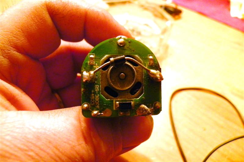

My Walkera HM#59D just lost the smoke out of the main motor So I took a look at it . It has a small PCB on it, and it was this that smoked. Out of idle curiousity, I unsoldered it, and re-attached the two wires to the terminals...and it works just the same. Just what do those little PCB's DO? ARE they really neccessary? WIll it completely burn out now? Hehehehe!!...

In my experience, hose little guys usually have a small capacitor in 'em, they sorta keep the power level more 'level' (know what I mean? )
I think some have a diode in them so if the motor were to become a generator (spin spin spin), the voltage wouldn't kill the thing the motor was attached to...

Thanks Chris! It crossed my mind it might be some kind of suppressor to avoid radio interference...
Maybe you are right...but it seems to run just fine without it!
Nick
PS...yes, that makes good sense, because when you cut the power, the rotors keep it spinning , turning the motor into a generator Well done!!

Resistors, a Diode, Don't see any Caps there...

Hmmmm...one way diode, to stop electricity generated in over-run getting back to the lipo battery...makes sense.

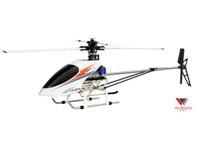

So what's a Walkera HM#59D?
I googled it and this is the only thing that came up.
FieroRumor
Posts: 35007
From: New York
Total ratings: 348
Report this Post12-13-2010 06:10 PM Click Here to See the Profile for FieroRumorClick Here to visit FieroRumor's HomePageSend a Private Message to FieroRumorDirect Link to This Post
fierofetish
Posts: 19173
From: Northeast Spain
Total ratings: 277
Report this Post12-13-2010 06:50 PM Click Here to See the Profile for fierofetishSend a Private Message to fierofetishDirect Link to This Post
It is NOT a vib...rator phonedawgz
It is one of these:
Nick

brushed motors need a capacitor to snuff false signals to the reciever. Brushless usually dont have them. Radios have gotten a lot better lately. Older ones got hit by everything electronic. Ive even wrecked race cars when someone used a CB before.
