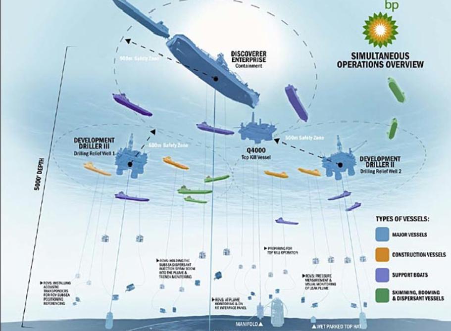

Here's a pretty accurate depiction of the activity above and below surface. You may have to enlarge it to read the notations, but that is a LOT of ROVs all in one place.
