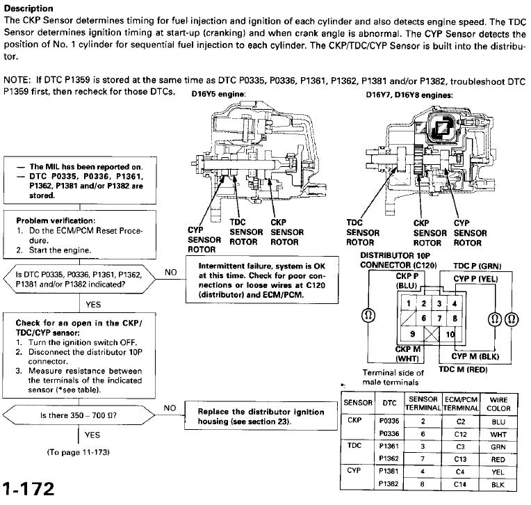

I have the shop manual for the 96 Honda Civic, my little brother has one. From page 11-101:
P1362
Top Dead Center
No Signal
-TDC Sensor
-TDC Sensor Circuit
-ECM/PCM
See page 11-172

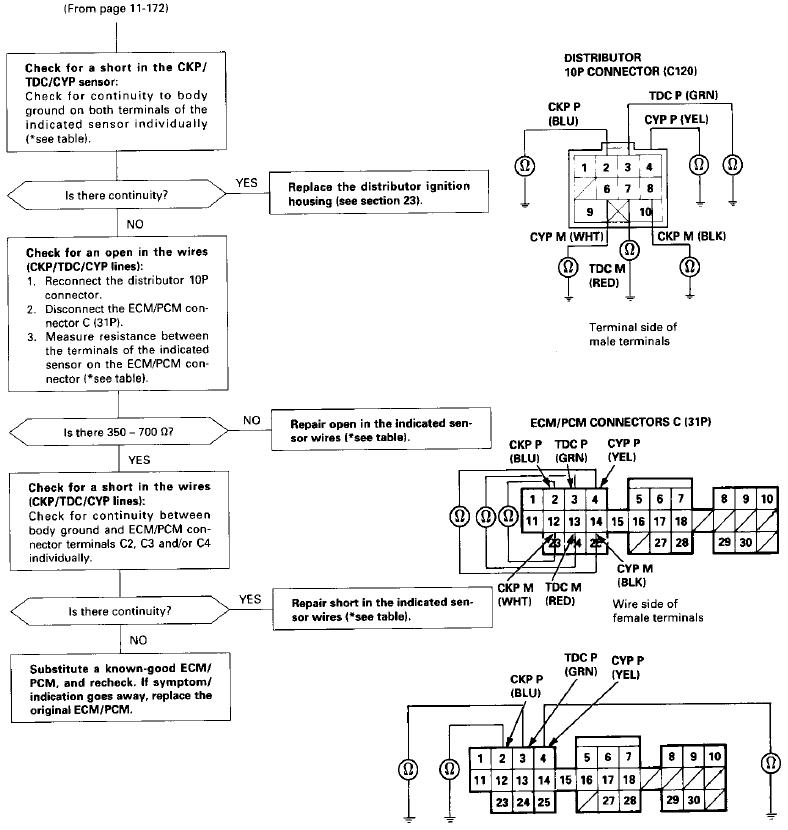

11-172:
P1362 - The scan tool indicates Diagnostic Trouble Code (DTC) P1362: No signal in the Top Dead Center (TDC) Sensor circuit
Get out the multimeter and check the resistance at the 10P connector, as indicated in the first flowchart / scan above, and go from there.
