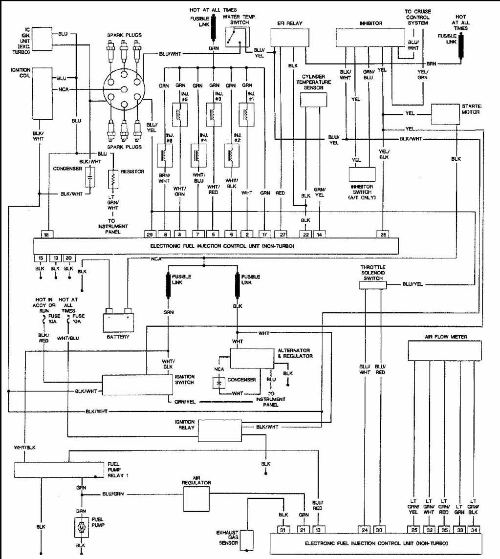

I have rebuilt one from the ground up.
The air flow meter is the biggest fault with the fuel system.
The pressure regulator should be near the middle of the fuel rail. The fuel pressure regulator should keep the fuel pressure at 36-37 psi at idle without vacuum at the pressure regulator.
The injector system is controlled through the coil. Basically, the coil tells the ECM when to trigger the injectors to fire. They all fire at the same time.
This may help:
-Dave
