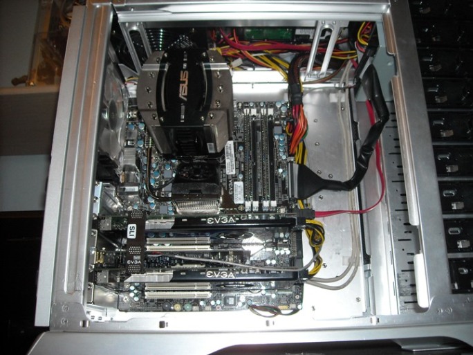

This will be a short build thread of a computer. I won't go into installing CPU, Memory, applying Thermal Paste, installing Videocards, scerwing down the Motherboard, etc.
Since this was already a running computer, this is more of a "Swap & Mod" assembly.
I will be taking the guts out of one computer and installing them in another case while lightly modifying, wiring & lighting the case.
I find the WIRING to be the most difficult part of ANY build.
Ideally, you want to hide as much of the wiring as possible, but in MOST cases, it's a matter of "Wire Management".
I guess we'll see how it all turns out.

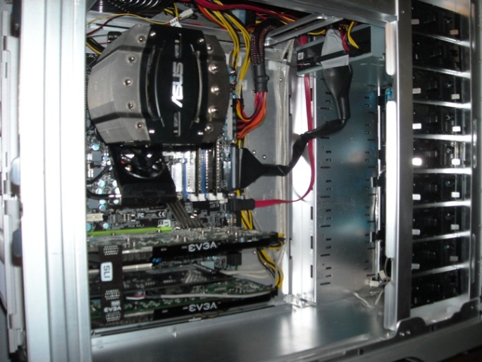

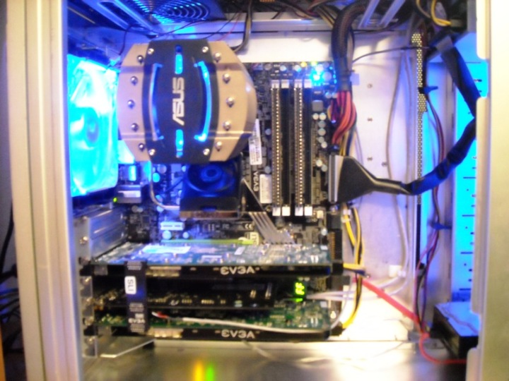

Motherboard Mounted To Tray, With Video, Sound, & Memory:

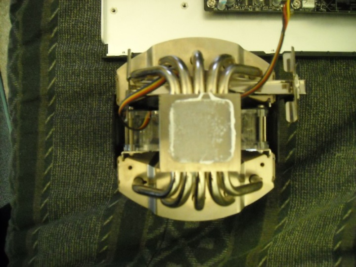

Asus Silent Square CPU Cooler:
Top View:
Videocards & Rear High-Speed Fan:

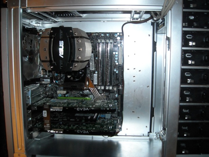

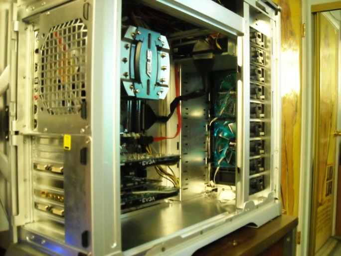

Motherboard In CoolerMaster Stacker 830 Chassis:
Videocards, CPU Heatsink, & Rear Fan In Case:

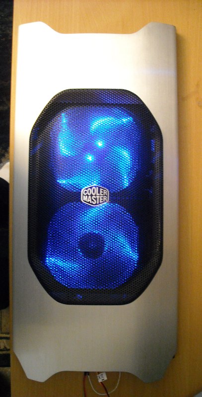

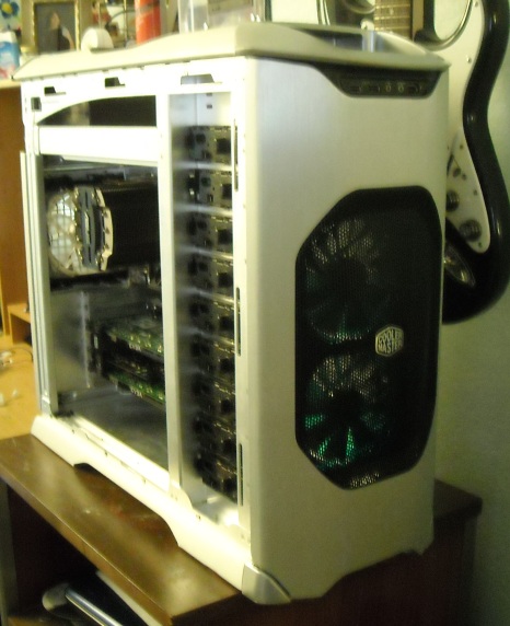

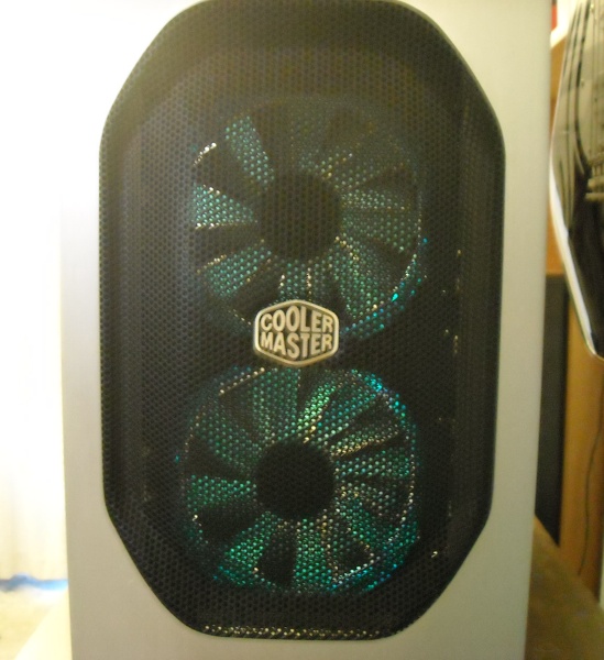

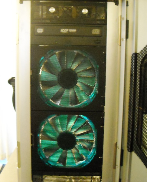

Front Blue-Lighted Fans, 2 Fanspeed Knobs, & Missing DVD Drive:

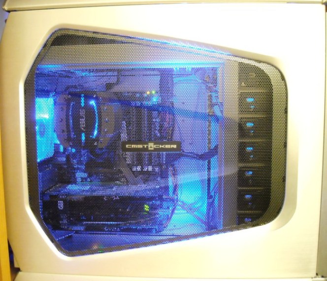

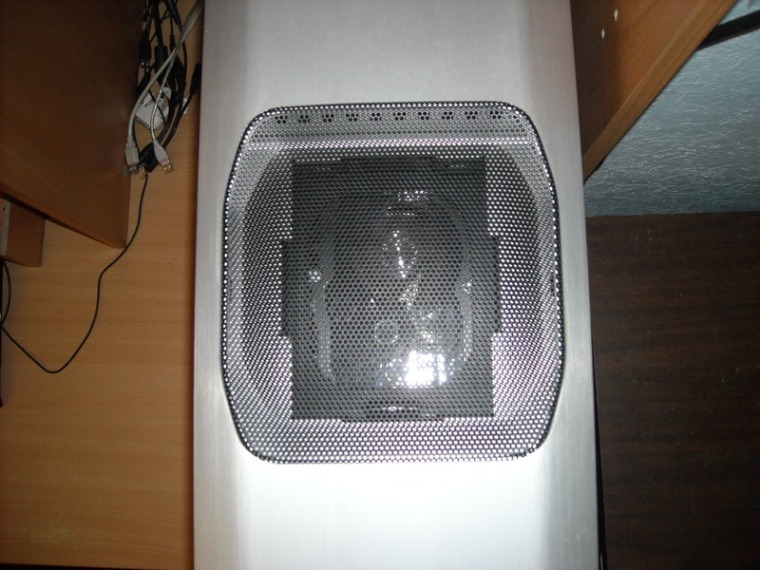

I'm Going To Remove The 4-Fan Inner Door:

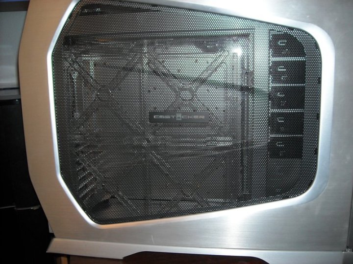

I'm Going With Just The Mesh, With Blue Lighting Inside:

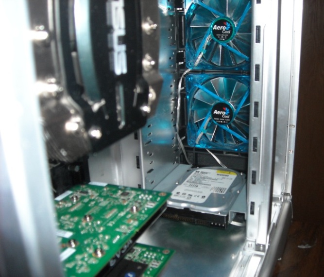

The Windowed Raptor X Hardrive Mounted In The Blue-Lighted Top Fan Slot:
The Rear With Powersupply & Dual-Videocards:
The Motherboard & Front-Panel Wiring:

you should take that heatsync to a machine shop and have them drill like 4more holes in it, drop small cold cathode lights in it, will look like its glowing from the inside

It has a 90mm bluelighted fan sandwitched in the middle:

ah, i though it was a fanless heatsync :P my last 3 systems have all been fanless, altho my lastone i did mods on was water cooled, no fans just a gental hum of a waterpump, and one night at 3am the loud beep of the water-low alarm, somehow from 9pm that night to 3am a good bit of the water just...went away, no leaks, no signs of evaperation...just low guess im glad i had that alarm, was missing about 8oz of coolant.. 16 total in the system.

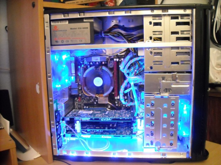

No wiring today.
I ran into fan planning problems.
The 2 front fans were very highspeed Thermaltake TT1225T's hooked to 2 speed controllers.
It is a cool set up, lowspeed is nice and mellow, midrange is totally acceptable, and highspeed is a monster.
But for MY setup, I got to thinking I might need something alittle different.
Remember the whole side of the case is going to be fanless, with just a "neutral" mesh.
So, the setup as it was would be:
2 - 120mm Multi-Speed Front Fans (highspeed) blowing into the case
1 - 120mm Single-Speed (midrange) exiting the case
1 - 120mm Powersupply fan (lowrange) exiting the case
No Top-Exit Fan due to Lighted/Windowed Raptor X mounted there.
So, it was pretty much 2 In, 2 Out.
Pretty even flow, while leaving the Side-Mesh neutral.
But the 2 Fans up front were adjustable in speed/airflow.
So once adjusted for "Neutrality", that would be the maximum airflow.
Any higher, and it would start bleeding out of the side mesh, and recurculating back into the front and through the system again.
So, in essence, the Fan Controllers up front, once adjusted to "Neutrality", would never get touched again, and could not be turned up for extra cooling during stress.
So, I went with Silent Midrange Fans up front, with no controllers.
Then, I put one of the High-Speed fans in back hooked to one controller.
Now, If I want to increase airflow during stress, I will crank up the REAR fan, which will pull more air through the front mesh, the venting around the Top-Fan grating where the Raptor X is mounted, and it may even pull some air into the case through the Side-Mesh.
I think that setup will give me more control over pulling air over the motherboard, while leaveing the Side-Mesh "Neutral".

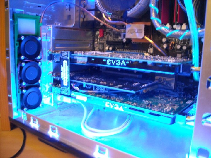

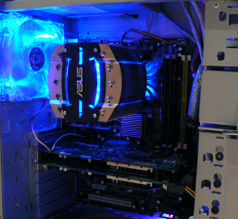

Now, I Have To Decide If I Want 3-Light - Clear Blade (bottom), Or 4-Light - Reflective Blade (top) Front Fans:
Day-Lit Non-Running From The Open Sidecase:
Dark Non-Running:
Where The Second Drive ( 320 SATA - the one below is not it) Is Being Mounted:
This airflow stuff really messed with my mind for more then just a few hours after work today, figuring out the kind of positive~v~passive airflow control I wanted.
Testing, retesting, combining, rewiring the controllers, etc., and all by using the power and connectors from another running computer!
Back at it tomorrow though, after work again.
[This message has been edited by Boondawg (edited 03-18-2009).]

Won't the weight of the CPU cooler cause too much stress on the motherboard? It looks like it wasn't designed for tower cases...
hookdonspeed
Posts: 7980
From: baltimore, md
Registered: May 2008
Total ratings: 131
Report this Post03-18-2009 09:00 AM Click Here to See the Profile for hookdonspeedClick Here to visit hookdonspeed's HomePageSend a Private Message to hookdonspeedDirect Link to This Post
cliff: most "newer" systems boards that are made for the mod'er/OC'er in mind are re-inforced on around the cpu sockets for this very reason... im hopping his does if not, aslong as he doesnt bounce the system around i think he will be ok.

Well, I gave her the good ol' back & forth waller' and it seems to be pretty solid.
The mounting area around & behind the CPU and the "spread-out' nature of the front & back of the mount itself seems to be built to handle just such stresses.
But in my opiniom it IS pushing it.
A part of me, though, DOES think it would be kind of cool if it DID break off....................but then again, I have been known to have a few issues..................

Looks like a very cool build you have going. Two 8800GT SLI will be as good or better than most of the performance boards on the market.
I would not recommend removing the side 4 fan inner door. You want a smooth path of air through your case. Most cases are set up to have air from from the front over the hard drive to the back and out through the power supply and rear exhaust fan. By removing that side door, you will hurt your air flow and cooling. That is why you don't see very many all mesh open cases. They are actually worse at cooling than a closed case with two fans in it.
I am inclined to agree with you.
But I think I am going to start there.
Then add fans as needed.
I mean, I have seen pictures of the Stacker being used with the inner-fan door attached but no fans mounted (but on second thought, they DID have the fan-screens installed...............)
I removed all of my fan-screens from the system, although I love the "Shadow Effect" they give lighted fans, I HATE their restrictive nature when it comes to air flow, and the amount of fine dust the collect. I would rather have streght-blowthrough.
I just never understood the design of most cases with reguard to airpreasure:
1 Exit Fan in rear of case
1 Powersupply Exit Fan in rear of case
~But Then~
2-3 Entrance Fans up in front of case
1-4 Entrance Fans in the side of the case
But it is ALWAYS 2 exit, and invariably MORE THEN 2 Entrance fans.
WTF?
Doesn't that create some kind of air-preasure inequality?

Fans can't really create pressure. It takes a compressor to create pressure. Fans just move air. With two exit fans and 3+ entrance fans, it just moves the air faster. The fans on the exits can spin faster since the air coming at them is already moving so they add even more velocity to it.

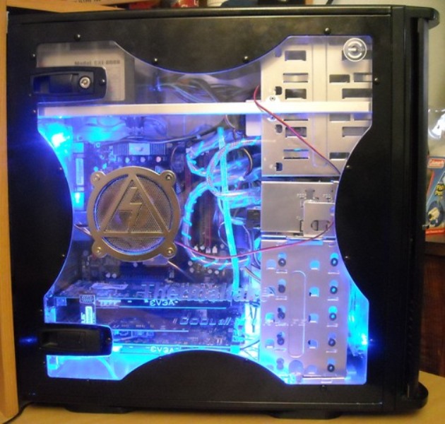

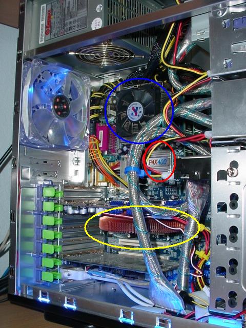

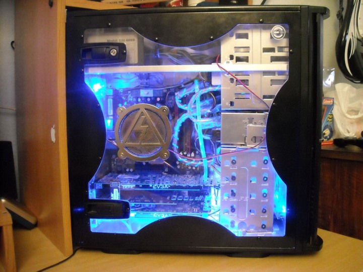

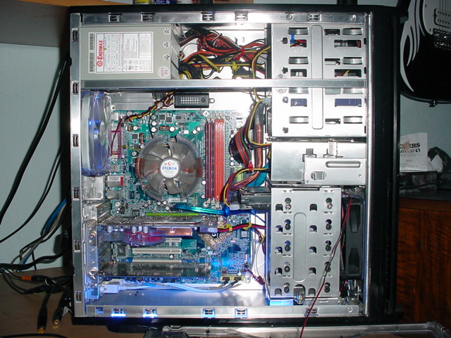

So, here's a look back at some of my early mods, some just the same case with different motherboards, and/or videocards, & lighting.
My First Mod. I Designed, Cut, Wired, & Lighted The Front Alien:
My First Motherboard & Videocard Mod:
My First From-Scratch, All Mine, Build (Motherboard, Videocard, Memory, CPU & Cooler, & Lighting)
The Borg Mod That Never Was (thanx, Picard.........beeatch!:
My Asus With Dual-Videocards, Lighted Cables, & Mini-Fan Video Heat Mod:
Ofcourse, The Glow Cube:
This Was Just An Art Deco Build, But I Tore It Down For Fan & Lighting Mods, As It Is A Strange Design (upside-down motherboard, powersupply at the bottom, etc.):
There have been MANY more computer builds, but these are the MODS that stand out.

I really do not want to do that.
I want a streght flow from front to back.
The Asus CPU cooler has a 90mm fan in it that pulls the air from the front of the case to the back fan, which the Asus Heatsink fan is just 2 inches from the rear fan.
The videocards pull air from the front fans, and exhast onto the side-mesh, which should be drawing fresh air from the front to rear airflow.
We will see, but I will vent out the top before I abanden the clear-view mesh.

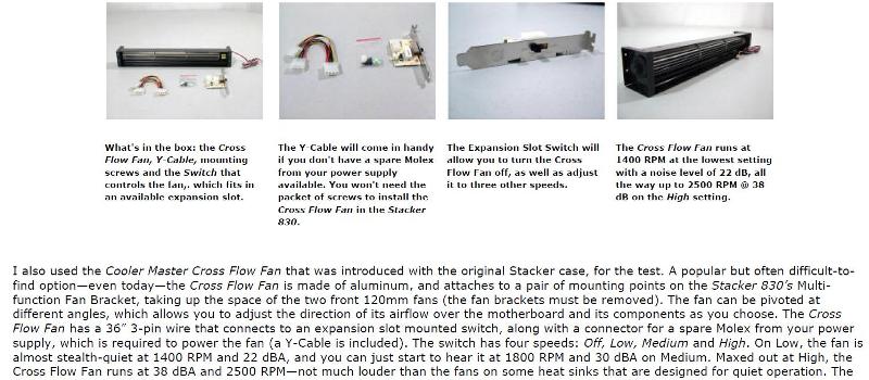

Or better yet:
http://www.uniquepcgear.com/comastcacrfl.html
I Would Want To Mount It Here:
Or Mount It In The Door, If I Have To:

With the open side panel, you're not going to get a clean front-to-back airflow pattern. There will be some bleed-through, in both directions. With all that open vent area, air will have no problem getting in or out of the case, which means that setting up an airflow pattern may not be very critical in your case (pun intended). Hence the side fan suggestion.
Actually, you could probably get away with no front intake fans at all. With all that open vent area, there will be no shortage of fresh air to draw from.
Anyway, I'm going to shut up now and watch you build your computer.
I really have no idea how well my idea will work.
But we should make a bet.
I say I will be able to put a single Zig~Zag rolling paper (my age-old method of checking airflow) almost anywhere on the mesh side and suction will make it stick.
I'm just guessing on it, but what you say?
Wanna bet?
The more I think about it, the more I'm tending to follow your thinking.
Some areas of the mesh will be pulling air, some will be bleeding air.
So tell me this: If I removed the Raptor X Drive from the top fan mesh, and put a "sucking from within" fan there (as intended by manufacturer), that should make the mesh "suck air in", correct?
Or ATLEAST not "bleed air"?

I jumped out of bed at 4am, screaming inside my head, "I know that Asus Silent Square CPU Heatsink has a fan in it, but how do I know I mounted it facing in the RIGHT direction?! What about that picture you saw (below) online?! Wasn't the "ASUS" name facing UP tword the top of the case?!" (yeah, sometimes I wake up solving WORK problems, too)
So having no manual, I go on line, and sure enough, there are little arrows on the sides of the Asus Silent Square CPU Heatsink pointing to the back fan of your computercase. So, off it came, no easy task, in the case.
But I never really mind, becouse I get to see how well my Arctic Silver has covered.
I may have to lap both CPU & Heatsink, as I see an aera I don't like, but that could have been made by the way I pulled it off by rocking it to one side.
But I'll do some temputure runs first, just to see if they look right:
(yes, I know, I see I put too much on!)
Got it all put back together, 4-something-a.m. in the morning, I thought, "What the hell, lets wire 'er up!".
Just The Front Panel Wired:
Fully Wired:
Just Waiting On My Front Fan Extension Cords, And I'm Go!:
I think it came out pretty clean, with the exception of the DVD cable..............I'll have to work something out for that.
Tomorrow, lighting installation.
Maybe fire her up on Friday!
[This message has been edited by Boondawg (edited 03-19-2009).]

Report this Post03-20-2009 10:11 AM Click Here to See the Profile for BoondawgSend a Private Message to BoondawgDirect Link to This Post
Batteries are almost out on my camera, but here she is running:
The air flow is somewhat strange. The back half of the mesh is sucking enough to stick a ZigZag rolling paper to the mesh, lightly.
The front half of the mesh won't nstick one, but it's not blowing any air out, either.
I need to do a cigarette smoke test, but I don't smoke anymore....................SEE, I TOLD YOU I STILL NEED TO SMOKE!!!!!!
But everything is REALLY running cool inside after 2 hours.
Still need to REALLY stress-test the videocards & get that heat cranking up , for a proper tempeture & airflow cooling test.
More to follow..........................
[This message has been edited by Boondawg (edited 03-20-2009).]
Awesome. Can you please post a pic of the top with it running?

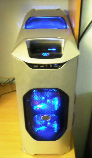

Report this Post03-22-2009 01:00 AM Click Here to See the Profile for BoondawgSend a Private Message to BoondawgDirect Link to This Post
All Done!

jetman
Posts: 7811
From: Sterling Heights Mich
Total ratings: 272
Report this Post03-23-2009 05:39 PM Click Here to See the Profile for jetmanClick Here to visit jetman's HomePageSend a Private Message to jetmanDirect Link to This Post
I knew that there had to be a good reason that my old PII 350 on dial up was chocking trying to load this thread.
Outstanding! That is one very sweet looking computer. I'm in awe.
I would love to do that myself someday.
