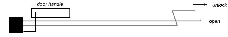

Well I took the panel off the passenger door to see how it works. I took the cover guard off the driver's door mechanism, and pulled the lock rod toward the front of the car, but it fells like it's jammed locked, like the lock mechanism is glued or rusted together (but the other doors have no rust at all). I tried pulling the lock rod towards the front of the car while pulling the inside handle rod (to open) and lifting the door handle, but it didn't do anything.
Here's what it looks like. The lock rod pivots at one point. Pulling th erod towards the front of the car (right side in pic) should unlock it.
Only two options I can see left are
-Tear panel off and try to get to the mechanism
-get to the back of the striker and drill out the two bolts that hold it in
I couldn't figure out how to get to the back of the striker, though. It isn't accessible fom the trunk, and there doesn't appear to be a fender liner at that part of the wheel well.
