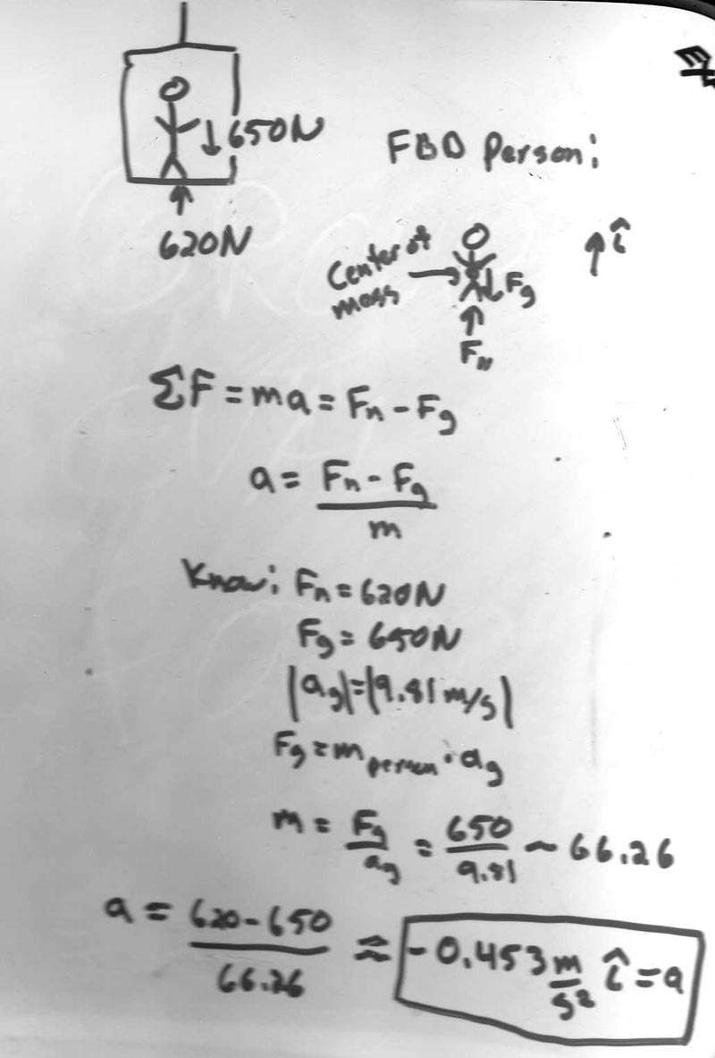

Don't show your roommate, otherwise that will be cheating. Feel free to coach him in the right direction though.
Nuts. Shyster gave the wordy version before I could scan the picture in.... Grrrr

I certainly understood it
Lets see if wikid_one follows now.....
