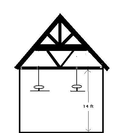

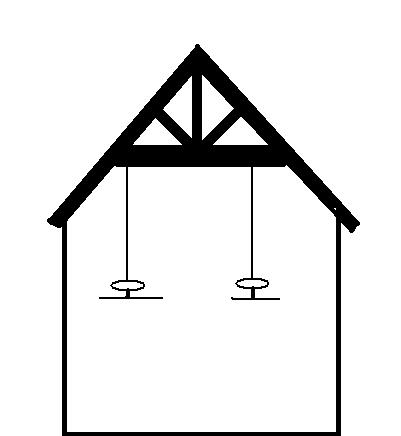

I have a horizontal beam from a truss located 18ft above my livingroom floor, that I wish to hang 2 ceiling fans (with light fixtures) from--if it is doable without the rotating blades causing an undue oscillation and the whole mass becoming unstable. Do they even make an 8-9 ft long down rod for ceiling fans?
The truss (collar tie) isn't clear here, as this is looking toward upper room, but you can see the height of the beam that will eventually be present. Diagonal supports/vertical 4x4 aren't in yet

I have seen them that low too, but have also seen them wildly swinging around out of control on a log rod, and really don't want that to be an issue. Usually from a balance problem of some sort, and from what I have heard, the longer the rod is, the more even a bit of dust on one blade can affect the rotating mass. I would like the light fixture under the fan to be about 7 1/2 ft to 8ft above the finished floor.
Another option is to add a manufatored beam just to support the fans and lights.
Would an added beam at top of wall height (14 ft) and supports look too bad? It's about 36' across this room.
