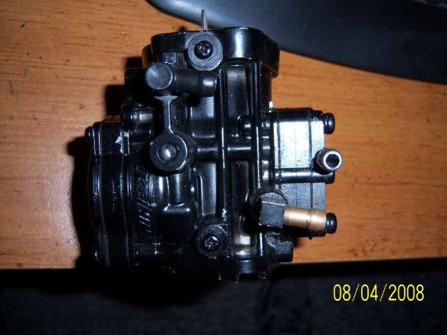

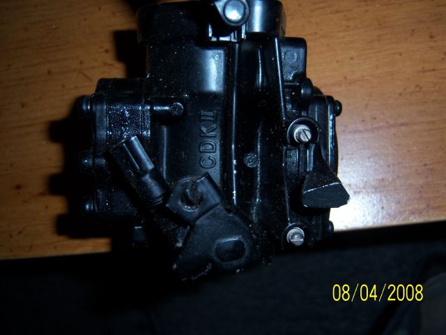

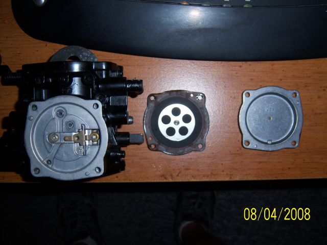

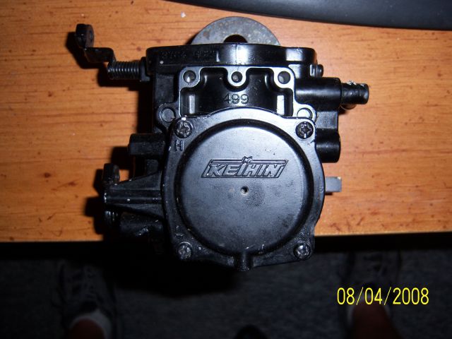

I found the carb although im not sure it is a 28 mm but i can pull it apart and send u a pic of the exploded view it may help.

Report this Post08-04-2008 05:00 PM Click Here to See the Profile for reddog1971Send a Private Message to reddog1971Direct Link to This Post
reddog1971
89 posts
Member since May 2008
the pix
If you want the carb p.m. with an addy and I'll get it out asap.
My carb dont have that other thingy in it,but again I'm not sure if it is a 28 mm or not.

You rock. Thats actually the next generation carb, from what I understand, but if it fits thats all that matters, and I think the bolt spacing is rather universal.
