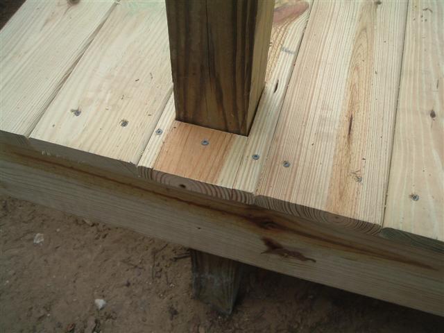

I just built a 16' x 24' deck in my yard. We too looked at going with Trex and about had a heart attack when we compared the difference in price. We have 16" deck boards, and if memory serves me we used something like 18 - 20 of them. The difference in cost of PT was $2500.00. I used to sell lumber, so I know the benefits of composite, and I really wanted to go that route, but $2500.00 is a lot of sealer of the next 10 - 20 years.
On a side note, some of you are probably thinking, what the heck are you doing building a deck while working on and planning the 25th? Yeah, I know, yes I am an idiot when it comes to time management. It had made things difficult, but I have been able to do this, the show and my real job. I just have not been sleeping much. I'll try and get some pictures of my work. Of course I still need to add steps and landscape. That happens after the show.
