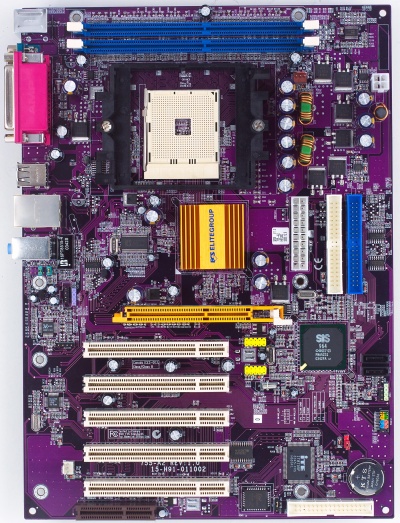

Looks like this is my prime candidate
pretty recent chipset, 8x AGP, the Northbridge controller isn't too close to the AGP slot (I'll be moving my Zalmann NB cooler there) and unlike the MSI board I have, the IDE connecters won't be up so close to the vid card either.
$36 Delivered.
