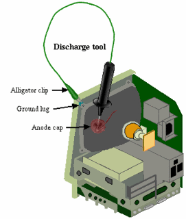

OK, lets try to get this straight.
I have worked on televisions for 30+ years. Believe me, CRT picture tubes can hold a charge. There is no "cable" in any CRT set (new or old) that I know of that discharges CRT's.
You can manually discharge a CRT but you should know what you are doing before attempting it.
The cable (usually red in color) with the suction cup attached to the CRT is the high voltage lead. If you disconnect it from the CRT, you can get zapped if you get near the connector under the suction cup.
Capacitors in the power supply can also hold a residual charge, but they usually are discharged through the circuitry they are attached to. Some caps in the newer sets with switching power supplies can hold a charge.
Not to say you can't get a good shock, but I've been zapped by both CRT's and caps, and you usually do more damage by the sudden jerk of your arm then the actual "shock" you get.

If you are talking about something that looks like this:
These are the different types of CRT degaussing coils. They are placed around the CRT to remove residual magnetism. They have NOTHING to do with the residual electrical charge stored in the CRT.
The CRT also has a braided ground cable or spring loaded to contact the conductive "DAG" coating on the glass envelope of the CRT. This would be "ground", however this ground doesn't magically discharge the CRT either.
The only way to discharge a CRT is to manually do it youself. see below:
You can use a screwdriver for a discharge tool, but you better be holding onto the insulated handle.
So in the picture below:
The red wire with the suction cup mounted on the reddish part of the back of the CRT is the HV anode connection.
The black cable draped around the dark part of the CRT is the degaussing coil / winding.
The silver braided cable running near the degaussing cable and down towards the chassis of the television is the ground cable.
