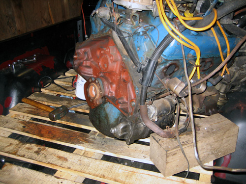

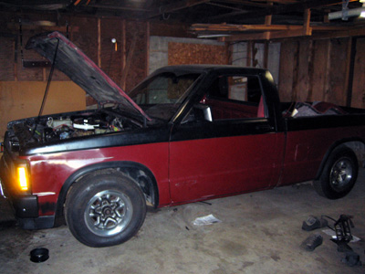

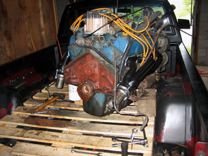

As some of you may remember a while ago I was looking at putting a 283 into my 1991 s10, long story short, plans fell through, and I ended up having to sell the 283. I got it for free, but put some new performance parts on it. I broke even.

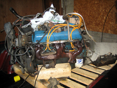

Now I just picked up a excellent running 350 cui, out of a 1982 van. Not a high performer by any means, compared to some 350's out of other vehicles, but hey, in a little s10 it'll go like a rocket. The van was an old district vehicle around here, hardly ever used but extremely well maintained, I talked to it's former mechanic and he said it's one of the best running v8's he's seen in a long time.
Anyways, heres the truck
And the motor/Trans...the boxes in the background are all my 3.4 pushrod parts for my Fiero, but thats a winter project..
I'll be updating this as I go along if anyones interested. Basically it is a stock 1982 350cui mated to an NV3500 5 speed transmission from a 4.3 2wd s10. The only modifictations to the motor are 4bl carb, and headers and custom exhaust. I'll see how that does power wise, and If I find my self craving more, i'll take care of it next summer.

Ok I have never worked on an engine attached to a automatic transmission before. How the fstarck do I unhook the trans from the motor (in this case TH400 trans from a 350V8). I took the bottom shield off that covers the flex plate, and theres 3 bolts I can see holding the flex plate on, but when I try and get them off they are on so tight it just turns the flywheel...man I hate auto trans...
Posts: 33026
Total ratings: 403
Report this Post06-04-2007 06:14 AM Click Here to See the Profile for Jake_DragonSend a Private Message to Jake_DragonDirect Link to This Post
You can pull the trans and leave the torque converter attached to the flex plate.
There are tools that attach to the starter ring gear that will keep it from turning, or you can try a big screw driver.
When you reinstall it dont install it with the torque converter attached you could destroy your front pump in the tranny.

Report this Post06-04-2007 11:23 PM Click Here to See the Profile for DisillusionSend a Private Message to DisillusionDirect Link to This Post

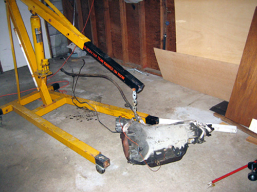

I win!!!..Got the th400 off, and it's sitting on my shop floor waiting for the owner to come pick it up!
Now all I have left to do hook it up to the 5 speed, and put headers on and it's ready to go in!

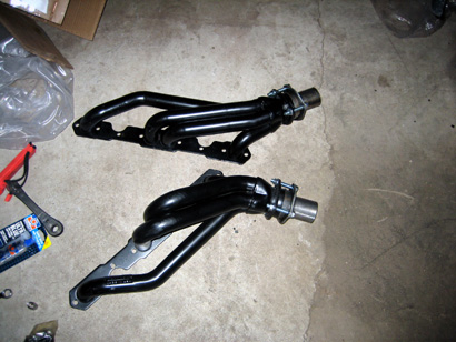

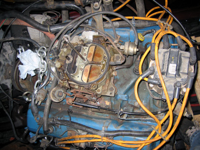

Got my headers/collectors put together and on the motor. Checked for clearance on the plugs and wires..it's a tight fight, but it works...I'm making some new heat shields tommorow, the old ones were pretty brittle, and don't fit with the headers.
What of all this crap on top of the motor can I get rid of, I've seen a lot less hoses/wires on carb'd V8's before. And emissions is 0 conceren here, so anything that is not 100% essential to the engine running good I want to get rid of.
(I have higher res photos if needed)

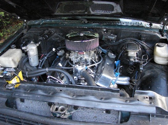

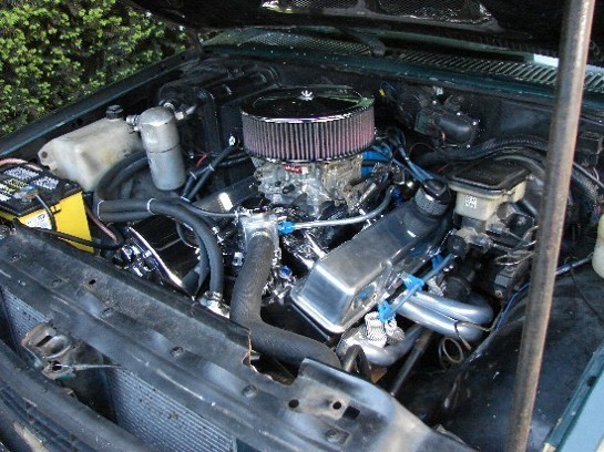

Report this Post07-25-2007 06:12 PM Click Here to See the Profile for DisillusionSend a Private Message to DisillusionDirect Link to This Post
So long time no update, mainly because I have no pictures at the moment cause my camera dissapeared. But the engine and trans and everything's all In and hooked up, the only thing left to do Is figure out what I'm going to do for fuel hoses, and then change the oil, put coolant in it, and cross my fingers and hope it starts!
If anyone reading this has a v8 s10, can you grab me a couple pictures of under the hood, mainly where the fuel lines/rad hoses are hooked up. Just want to make sure mine looks 'normal' before I try and start it and spray gas/coolant everywhere.

Report this Post07-25-2007 09:20 PM Click Here to See the Profile for FIEROPHREKSend a Private Message to FIEROPHREKDirect Link to This Post

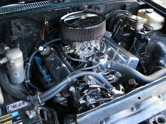

Here are some pics to keep ya motivated ! This is my S-10 blazer with a 327.
Now get to wrenching !

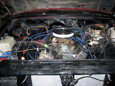

Well, progress sort of. I am getting the clutch hooked up when I get the exhaust made so thats a big load off the shoulders. All that I have left to do before it goes off to the shop is clean up the wiring, and figure out grounds, right now it's not getting enough juice to turn the radio and headlights on at the same time. If it's not that then my alternator or battery is bad again. I did take some pictures though!
Wiring mess! I'm getting it all running and grounded good, then I will tidy up the wiring
The truck. It's dirty as sin and greasy to boot from sitting for 2 months almost. I did a 2" front 3" rear lowering kit on it, because the old suspension was shot, and a lowering kit was cheaper than stock stuff for some reason
I know the tires have gone a bit flat..er a lot flat. I need some nice wheels to fill out the wheel gap when I recoupe a bit of finances!
