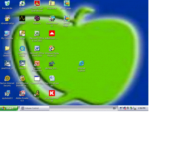

Don't you guys just love my little drills?
I have a system in the shop, XP Home. The volume icon shows up in the lower right hand corner of the screen. Single click, the little volume control pops up. Groovy. Double-click the icon to bring up the advanced volume control panel, and poof, the window shows up in the task bar. But look! It's not on the screen anywhere! Right click the window in the task bar and say "Move" and the cursor jumps up to the upper left hand corner of the screen, but there's nothing there. I've run several utilities and the only thing I've found that offers a hint is a little program that gives specifics of open programs. The volume control sows as the window is hidden. I can't figure out how or where that particular "setting" would be located.
So, any ideas?
By the way, so far I've:
Uninstalled the sound card and drivers and reinstalled.
Run Window Watcher (http://www.karenware.com/powertools.asp) (some nice little apps there for you geekazoids)
Run RegmonNt
Run a couple of registry repair programs (as Regmon returned some errors in association with the advanced volume control) but still nothin'.
The floor is open....

Taijiguy, can you post a screen shot of the problem? That might help.

Not a lot to see:
This images is larger than 100K. Click to view.
You can see that the volume control shows up in the taskbar, but nothin you do will actually make it appear on the screen. This is the advanced volume control, that would have all of the various inputs listed, such as line in, mic, etc.

First, click on the volume control in the task bar to make sure it has focus (even though it won't come up on screen) - that way Windows shouldn't treat it as minimized. (or right click on it and click on "Restore")
Right click on a blank area of the task bar, then click Cascade Windows (or one of the Tile Windows options)
See if that arranges it on your desktop.

It sounds like the window has been moved off screen.
Just a little tip that might work: change your screen resolution to the highest you can, then see if you can see the window.
Chances are its in the upper left corner.
If it's not that... I'm stumped and would recommend a system restore, lol.

Thanks for all the replies guys. Tried all that stuff along the way, even tried a system repair installation, still nadda. No idea what the probelm was. The kid who owned it was buggin' the crap out of me, calling me a couple times a day, I fiannly just told him to come and get it. I *would* have loved to know what the probelm was though.
