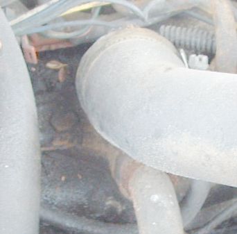

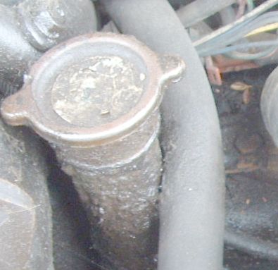

I would use a lockwasher to prevent the nut from loosening again. There is a bracket under the bolt on the passenger side... appears to be for the oil filler spout. You should have no problem dealing with the bolt as long as the other side has been secured first.
Shot of the gooseneck showing the bracket under the bolt
Shot of the oil spout and bracket... looks like they may be related

Thanks for the photos. I took a closer look at the bracket, and it looks like it holds an electrical connector of some sort.
