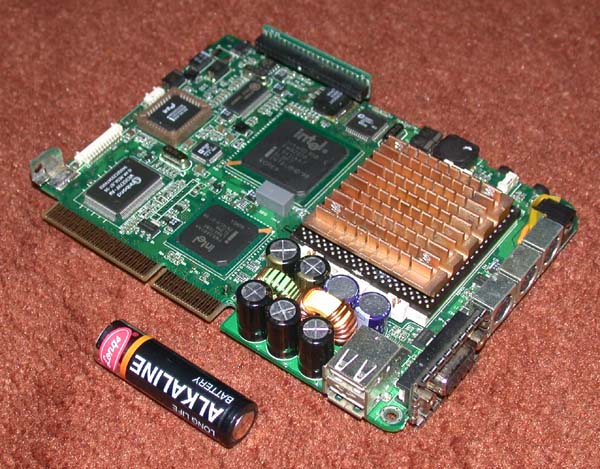

The reason I want to keep this motherboard:
I've included a AA battery in the picture for size. This thing is small! It has two USB ports, onboard Audio (in & out), onboard VGA and TV out (Pal & NTSC). The space to the left of the CPU is exactly the size of a laptop HD and can be directly connected to the black connector you see.
Anyway, I just measured the voltages on some pins, and either the mobo doesn't detect FC-PGAs anymore or both my FC-PGA processors are fried.
