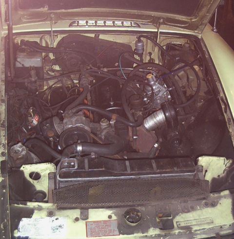

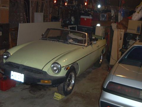

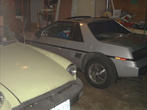

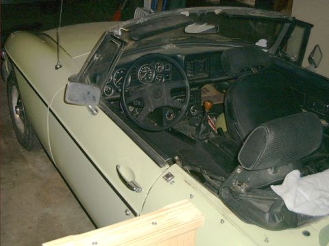

The parts to fix the alternator and the rear brakes should be here Wed or Thu. If I can, I'm going to take a victory lap around the block...
And here are some pics.
The car in the garage:
The interior:
The engine compartment:
And of course it's "roommate"

In fourth gear, every 1,000 RPM is 18 MPH, so you do 54 mph at 3,000 RPM. Or 63 MPH at 3,500, or 72 at 4,000... you see? Redline is around 5,500 or so IIRC, so that would work out to a top speed of 99 MPH...assuming the engine has enough oomph to get it there, which I highly doubt. Like I said above, the '77 goes 0-60 in 17 seconds, which won't even beat a Suzuki Samurai much less a 4-cyl Fiero.... But they do handle nice, they're stylish, and fun.
The overdrive was actually a good idea, but my Dad's car doesn't have one. Basically it seems to me that the overdrive essentially gives the car, effectively, an 8-speed transmission if you use it right.
I don't recall which year they switched to negative ground, but I know it was before 1977. Dad's car is negative ground.
I thought about going to a one-wire conversion but the last thing I want to do is get involved with modifying British wiring. Bad enough that the thing has Lucas electrics in it....
Ed

Originally posted by edhering:
Ed
That pic is pretty nice. I really loke the look of the MGB.
If you have one in prefect shape, they are a verry classy sporty car.
Kind of like its big bro next to it in your pic.
That volvo turbo sounds so sick.

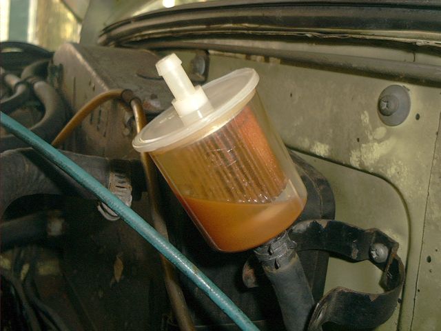

Today I got to take the car for a drive!
I rebuilt the rear wheel brake cyls and it turned out the pads were just dirty, not ruined, so I cleaned them and put them back on, figuring they'd be "good enough" until the new ones get here. Bled the brakes, got out the camcorder, and Dad and I took 'er for a spin!
We stayed in the neighborhood (we'd planned to) and went around one block, then went to go around another...and then it choked and died.
We had to push it most of the way home. It would run but once I tried to let the clutch out, it was like someone just pulled the plug--it would die. Just die, not choke, not cough, just RRRrrrrrrr clunk.
Me:
So I checked some things. It was low on coolant, so I topped it up; then it started and ran fine. I let it sit and idle, and it got hot enough to turn the fans on, and still had enough power to move up the driveway. Okay, so I tried it again on the street.
I got a block down and it did the same damn thing! It was like the stupid thing was getting homesick or something.
So I began trying to figure out what it could be. The ignition? No, unless the ignition box was overheating or something.... There's still water dripping on the distributor from the heater valve...no, it can't be that, because on the second run I had a bag tied around it--no water on the dist. this time. No, this was actling like some kind of fuel starvation problem....

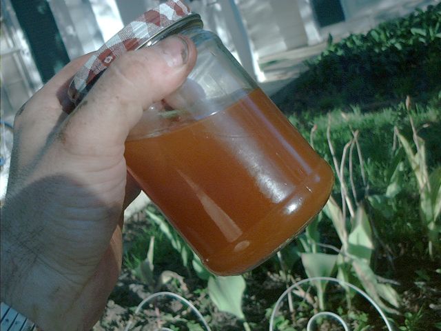

Then Dad suggested I check the fuel filter.
AAAH!
Then he wanted to run the fuel pump to see if the fuel supply would clear up after a bit.
This was the fourth jar's worth:
Well, it makes sense. After sitting for ten years, there's a bunch of crap inside the tank. Driving the car around sloshed the gasoline around, which dislodged the crap, and hence...well, the pics are proof enough for me. SO, the next project will be cleaning out the fuel tank!
Ed

Looks kinda like rusty water.

As bad as that looks, I bet you could still get $2.25 a gallon for it on Ebay.
