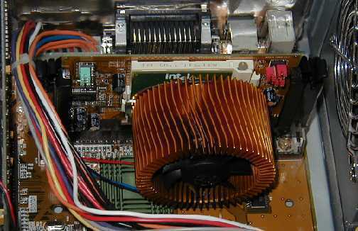

Hey kids! Got my computer back together again and it's running great. Installed my new 566 Celeron, convertor card (Abit Slotket), and Golden Orb cooler tonight.
I bought this combo from Sunshine Star (see URL below) and they told me the 566 CPU chips are tested for 72 hours at 850 MHz before they are shipped. I got my upgrade kit in exactly one week from the time I ordered it. Sunshine Star has almost unbeatable prices for us cheap overclocking folks.
Anyway, I installed everything, fired up the computer and it ran flawless at 850 MHz as promised...yippee! I ran the Unreal demo loop for several minutes, no problem. I ran Wintune to get some benchmarks. Wow, lots better than my old CPU.
Just for kicks, I rebooted and set the bus speed at 112 MHz. I was running at 100 MHz bus speed prior to this (8.5 clock multiplier X 100 MHz = 850 MHz). It posted and then loaded Windows...HOLY GUANO...953 MHz from a 566 chip. I'm using 1.65 core voltage which is default on the P-III, although default on the 566 is actually 1.5 volts. However, the Celeron chip Coppermine is the same as the P-III Coppermine, except for the cache. I'm happy, I got a great deal!

Batboy, do you know which week your processor is? Or do most 566 overclock so easy to 850? I'm thinking of replacing my C366@550 for a C566@850...

Cliff, I now wish that I'd wrote the numbers down off the chip before putting the thermal grease and heatsink on. I'd rather not pull it off right now...hehehe. I have heard that nearly all Celeron 566 chips can be overclocked and that most will run stable at 850 MHz, especially if you increase voltage to 1.65 (same as P-III Coppermine). Mileage may vary, but I'm hearing maybe over 90% success rates. Go for it Cliff, it's a bargain. The Celeron 600 is not as easy to run at 100 MHz bus speed. I love my new Golden Orb cooler, it works great.

Cliff, I looked at my invoice and found this info, maybe it will help: Intel Celeron II 566 FC/PGA OEM, S/N# L024A426-1231.

Thanks, that did help. The first three numbers of the serial number is the manufacturing date. So it's a 2000 week 24 chip.
BTW, love the cooler! How much did you pay for that?

Cliff, I bought this as a kit from Sunshine Star (look for their URL in one of my earlier posts). The CPU, converter, and cooler together were $150 US plus $10 US shipping. The invoice breaks the kit down like this: $120 for the Intel 566 Celeron II chip guaranteed to run 850 MHz, $15 for the Golden Orb cooler, and $15 for the Abit SlotKET III converter board (needed to mount a 370 chip to a slot 1 motherboard). I don't know if they do international shipments. Good luck... Celerons and Durons overclock and rock!!!

Batboy, couldn't find that cooler on their website...

Batboy, when I first saw that photo, for a second I thought it was a K&N filter.. LOL.....

Cliff, the cooler is not mentioned by name and there is no pic on the website, but when I was on the phone with them asking questions before ordering, they told me it was a Golden Orb cooler, and that's what I got. Plenty of other vendors sell that same cooler individually. I'm not sure if Sunshine Star sells them separately or not. The pic in the earlier post is my own photo I took of my CPU and cooler installed in my computer.
