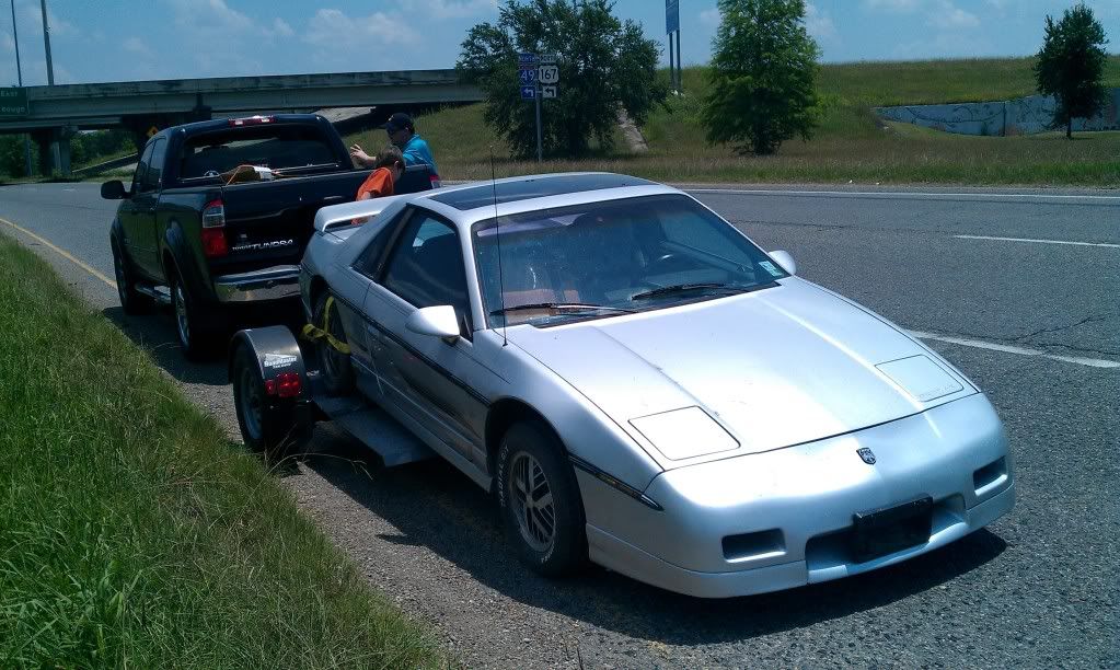

Report this Post06-12-2012 09:02 AM Click Here to See the Profile for carbonSend a Private Message to carbonDirect Link to This Post
On a dolly with Rodney's 1" lowering ball joints...
Before wheel straps obviously...
