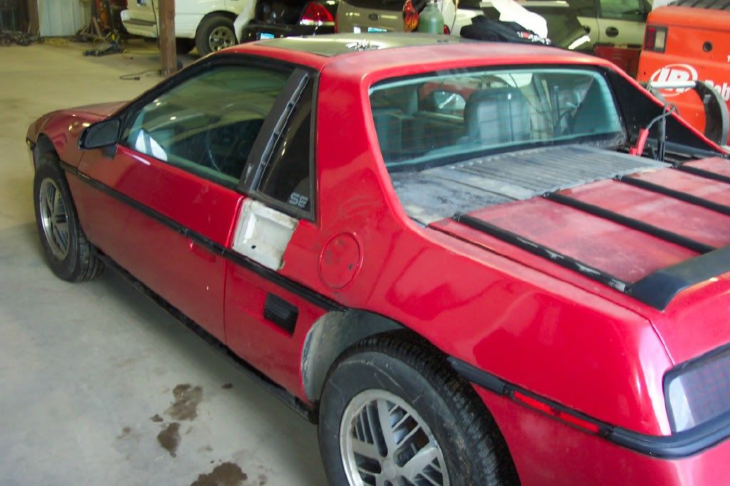

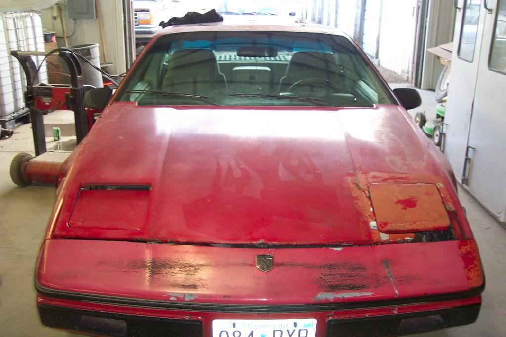

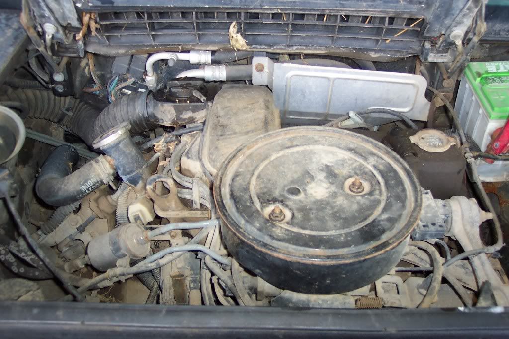

Interesting, looks like a pre-recall decklid (has the vent and rubber seal, which are GOOD things) and possibly a pre-recall motor, since the engine has the dipstick tube in the back facing towards the battery, but has the post-recall dipstick? Does it have the heat shield between the exhaust manifold and the head?

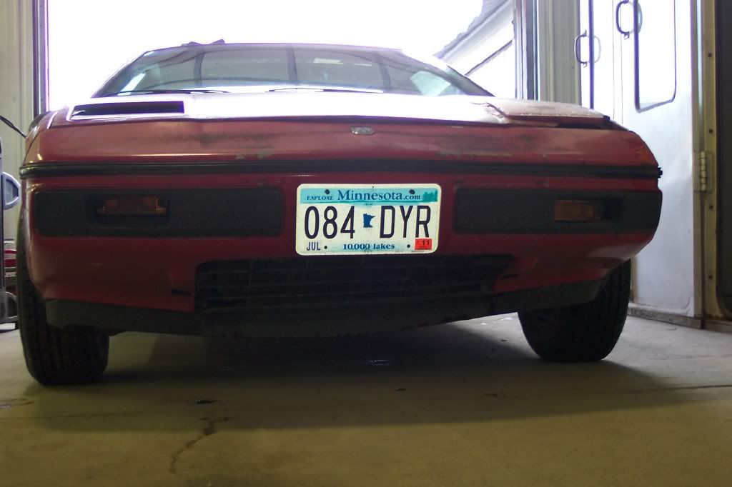

Looks like it has some front end damage, take the bumper off and have a look. New hood and headlight doors should be easy to find, the notchback clip takes a few hours to replace.
The trunk is caved in on the right side like somebody tried to jack it up there, check the coolant pipes for crush damage.
Apparently whoever ordered the car got every option but automatic transmission

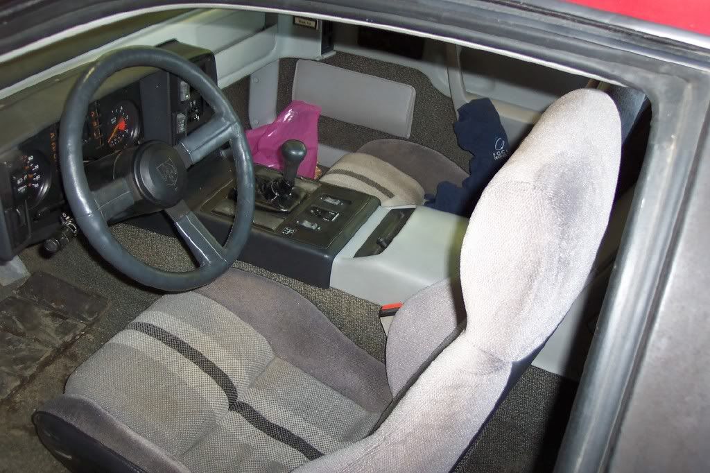

BTW, what's the button between the two power window switches? Power mirrors?

The button between the power window switches is the OEM power mirror switch. You select which side you want to move and then can adjust the mirrors.
