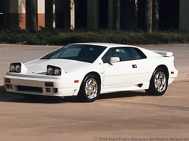

Here are some pop-ups for inspiration:
355
348
f40
Testarossa
GTO
An Espirit
And an NSX
The NSX looks the best IMO.
