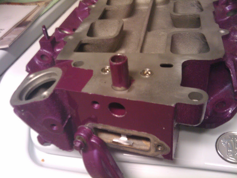

Here are some pics of Vince's Fiero that I haven't had time to load up until today...
Starting point.....
Test fit of the accessories and logs....This swap will be receiving the first set of Ryan's logs (endorsed by the Guru ). Once the fits are exactly as we like, Ryan will be offering them up for sale. The first three sets run are already taken by Vince, Dave D, and myself. I fell a little behind schedule due to my cold/flu last week, but I'm back on track now.
Also, we fabricated a low mount alternator bracket and I plan on fabricating a steel dog bone mount....rumor has it that there are a few people that are unhappy with their aluminum dogbone mount and I figure I'd try something a little different.

bmwguru, I see you welded the holes in the LIM. You need to open up the coolant flow passage under the rectangle cap on the side of the LIM or you are restricting coolant to the opposite head.

Jncomutt, thanks for the info. Ya learn something new everyday. I'll be sure to take care of this on my swaps.
