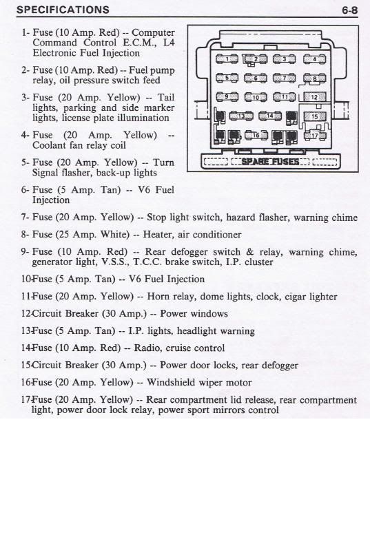

Originally posted by larini74:
Check the Battery fuse on the fuse block
that controls the radio, horn, (on gt's the Pontiac lites in the back) etc.....
Fuse #11 on this diagram. I had the exact same issue a few weeks ago.
