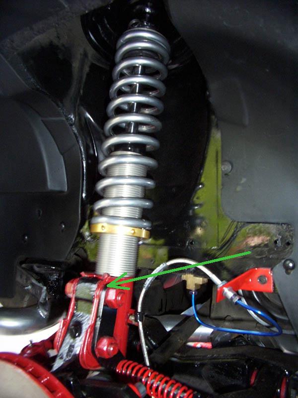

Be aware that you may have an issue with the wheel hitting the strut knuckle. I don't believe 17" wheels have the gap to go over the top of the knuckle. If you are running the stock wheels right now, look under the vehicle and see the clearance from the top of the inside wheel lip to the strut knuckle. There is not much room there.
Edit....this is a pic from another member. This is the knuckle I am talking about. The stock 15" wheel almost touches this point so the larger wheels 18-20" slide over this knuckle. I think the 17" wheels would still hit if the offset is too far inwards.
[This message has been edited by IMSA GT (edited 08-27-2011).]
