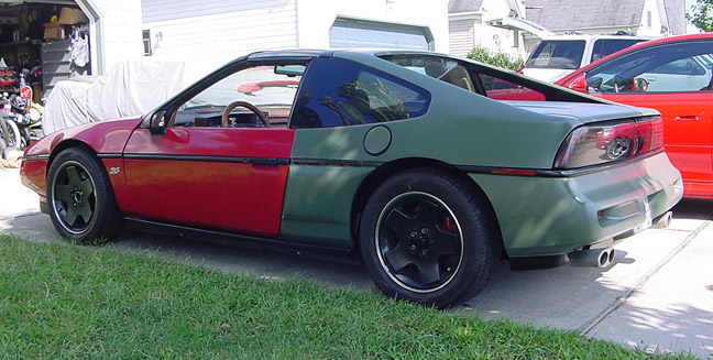

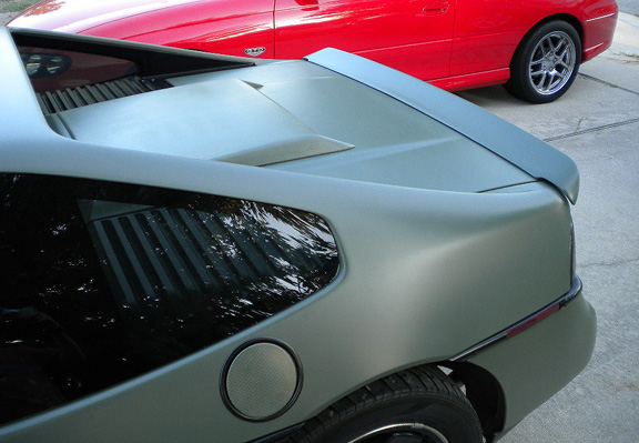

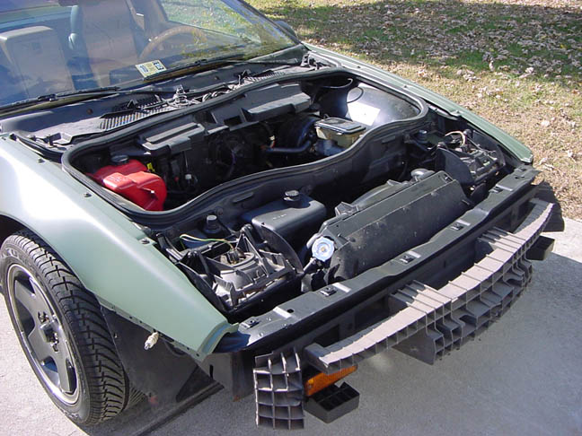

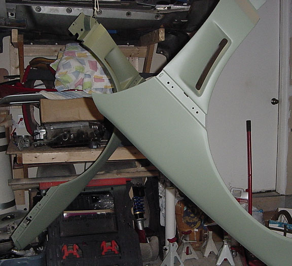

whole car with Krylon "Satin - Italian Olive" from Walmart. Took about 15 cans or so, I still have a few in the garage. I bought about 3-4 at a time. Also used about 8 cans of Primer under the Green. Took off each body panel, sanded them down, fixed little imperfections and then primered. Sanded the primer, reshot it, sanded again. Then when the primer coat was good, I hit them with the Krylon. Sanded the first coat, repaint sanded the second and then applied a third. The last coat was not touched. It is as it came out of the can. No one, and I mean no one can tell its spray paint. Its been on for over a year and a half and it still looks great.

Thats the key with spray paint. Use a satin finish and it looks awesome when you are done. Use a gloss finish and be prepared for the sanding and buffing to actually achieve a glossy shine......for a short time.

God. I love that color!
