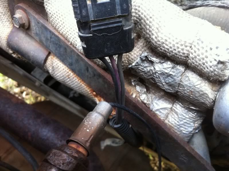

i have a 87 4 cyl school driver and the pump went bad i got the pump out but dose it unplug or do u just cut the wires???

It unplugs. If you look towards the firewall you'll see the three wire connect going down to the tank. It's usually placed behind the catalytic converter heat shield. You can also see it from below with the car up in the air.

It unplugs. Here's a pic of it unplugged.
If I could look through the engine it would be HERE against the firewall. Coming through the insulation just below the large harness.

Unplugs. Here is a pic of mine on my duke. I cut the top of the pic off. >.< At the top of the pic is the connector. You can see some of it but not all.

When you say you've got the fuel pump out, do you mean just the pump, or the whole sender assembly with the float and the tubes? Both unplug, the whole assembly unplugs at the firewall as others have said, the fuel pump itself unplugs right at the top of the pump. The terminals plugged into the top of the pump have release tabs you press and just pull the connector off.
