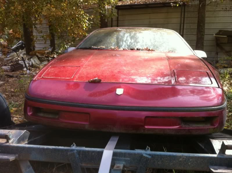

not a uhaul trailer but built pretty close to one.
