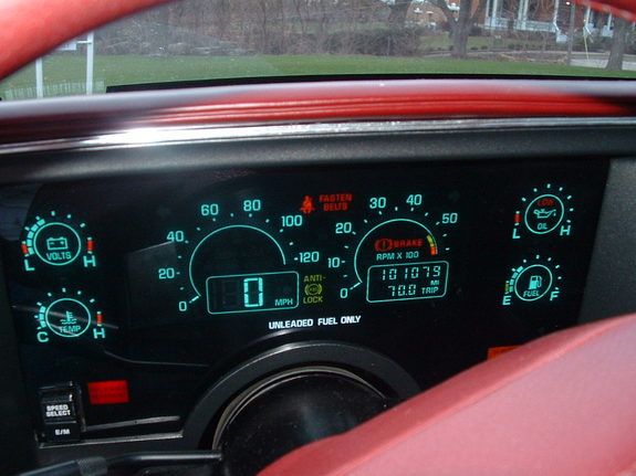

This is what it looks like lit up:
It also came in the Riviera, which is where I got mine from. It is known as the UB3 digital dash.
There are several models of the UB3 dash, Oldsmobile, Buick and Chevy used the nomenclature,
but the gauges look different for each.
