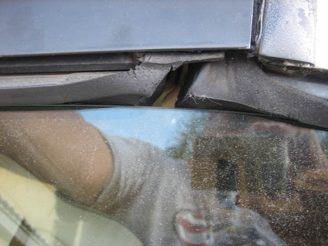

It’s been a rough week.
I have had to press my Fiero into early spring service this week since my gf backed into the side of my DD, and it is in the shop for body repairs.
My Formula t-top has the typical old, leaky weather seals, and it has been raining every day this week! I am flooded out!
I spent weeks last summer trying to apply stick on weatherstrips to slow/stop the leaks, tried some new seals which I was able to get but that did not help much. I tried readjusting the side door glass, no help.
So here I am getting rained on commuting to work, in 35 degree temps, with water coming in all around.
It is such a shame too. The car has been repainted within a couple years, only 90K miles, new front bearings, plus new shocks/struts, tie rods, brakes all around as well as a few other misc. parts. It is a great Fiero, except it is only really good to drive in nice weather.
I have had a Fiero for 14 years, this “new” one to me for one. For the first time, I am tired of Fieros. This water leak is demoralizing! I should have looked for a sunroof/closed roof car instead!

As a temporary fix, could try taping up the seams of the tops on the outside. May not look pretty but should hold till your daily is ready.

Doesn't JCwhitney have a unviersal weather strip available? Someone, somewhere has to have the correct style to replace the worn out piece.

Wear, age and how well they were installed to start are the main factors if you have a leak. I have had mine installed since 1987 and still they hold up.
I have noted over the years often the aftermarket installs are often done better and the trim was install a little better than the C&C plant installs. A C & C dealer installed mine and one guy did it in a day. He did a really good job.
As for stiffnes there is no question is has more cowl shake. You cut the roof off any car that was not designed to do so it will flex. Welding was never an option as non of the T Tops were assembly line cars. They could never weld them with the inteirors in them. The RIvets do a good job if installed properly. Weld would not be much better as the car twist more than anything. It really needs some support under the car for rigitity lost on the sides.
The Fiero came out pretty well and for the most is a good design. If you want leaks check out any T Top from the 70's . The Hurst Hatch cars all leack from the day they were installed and never would stop.
T Top cars are not maintenace free and the seals take care. Also as the cars age they do need adjusted too. If you tweek them a little often the leaks can be resolved unless the seals are damaged. Most often they need adjusted on the split between the top and the car. Adjustments will also remove wind noise that many of the leakers have too.
